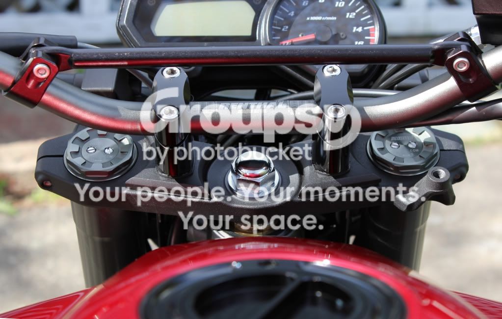

If you haven't sold the bike yet, can you post some pics of the headlight mounted to the triples? Or however you mounted it? I've got my front end complete minus the mounting of my headlight. I used an 05 ZX6R front end and 07 R1 triples. Mounted up with a simple bearing swap from All Balls Racing. Anyway, some more pics of the headlight mounting would be greatly appreciated.

Sorry for the delayed reply; The bike has sold but, I think I have some photos of the mount kicking around on my home computer. I basically modified the FZ1N stock bracket to match the new upper-to-lower triple spacing. The lower position of the mount bolted directly to the lower triple clamp (Utilizing the existing stock threaded hole, must have been to mount the brake line manifold). The upper portion was a little more complicated: I added two small angle brackets to the lower side of the of the upper triple clamp (They were held in place by the bar riser bolt). The angles extended out toward the front of the bike creating a "shelf" which the upper portion of the headlight mount would rest. Two simple socket head cap screws allow fitment/adjustment in an easy to access manner.
I will see what I can find for photos when I get home tonight.
On another note: I am sure I am not the only one that would love to hear more about the simple bearing swap to mount the R1 triples. A Question comes to mind: Does this account for the difference in total length of the steering stem? Like I said, I would love to hear more.

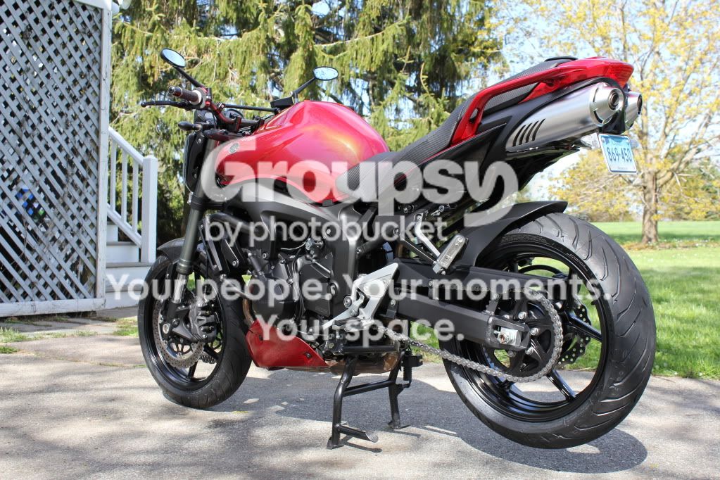

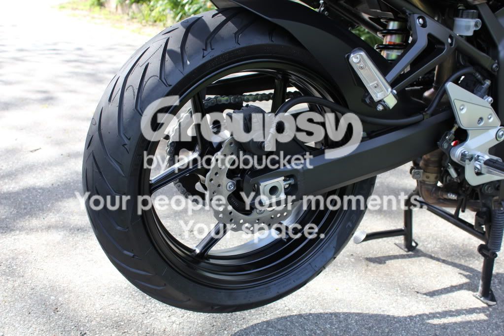

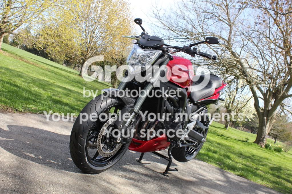

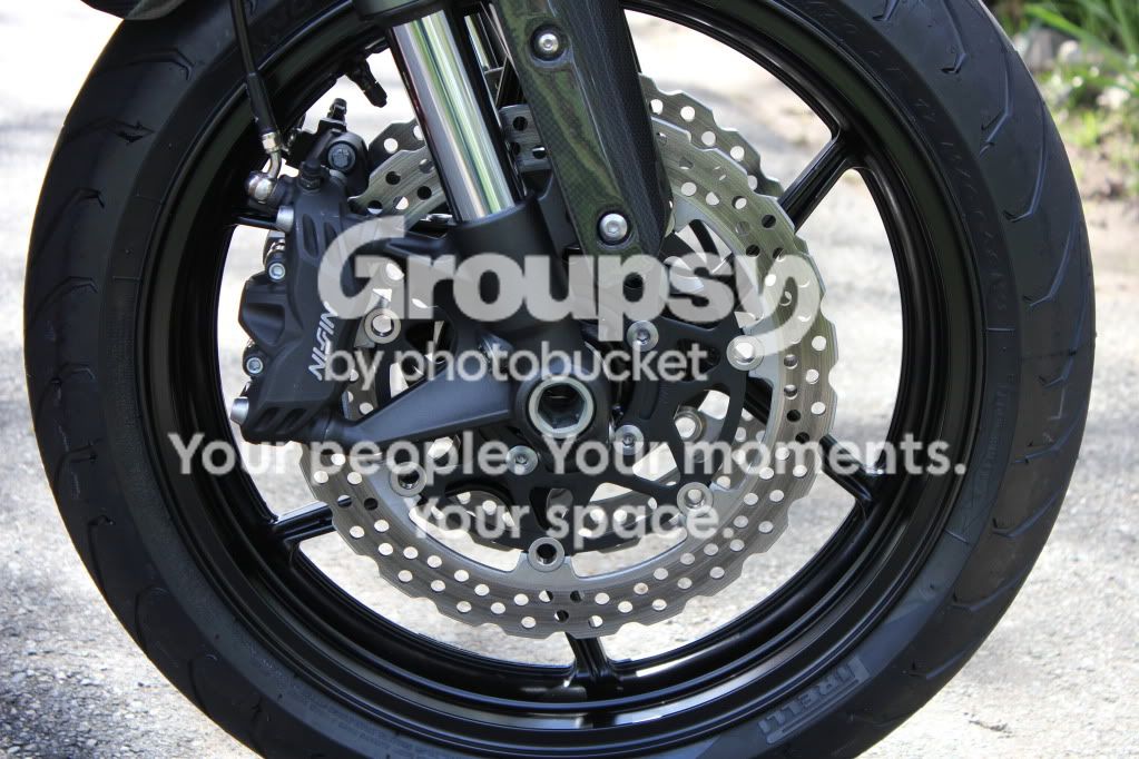

Finally have everything completed with respect to the wheels. The ZX6R wheels have been stripped, powder-coated "Sable Black", bearings replaced, Pirelli Angels Installed, and finally sprocket and freshly painted rotors installed.
Puuurrrdddy!!!
Front Wheel with Flat Black Rotors:
Rear Wheel with Vortex Sprocket Installed:
Overall #1:
Overall #2:
