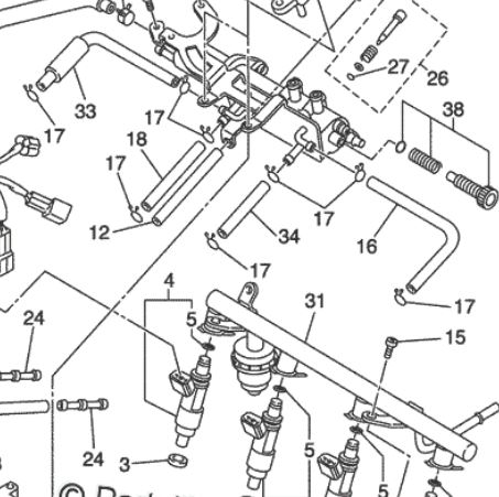

Good image Scott. Yes, item 31 is the fuel rail. If rust makes its way past the in-tank fuel filter it can get impacted into the fuel rail. This restricts flow. You may be able start the bike, but the limited flow quickly results in fuel starvation. Do you notice the rpms increasing just before the engine quits?

It's not the mushroom on the rail its part of the sender unit. Another easy to tell is that if the fuel line is disconnected it will have constant fuel flow due to being stuck open not just a dribble like standard.
Regulator circled in pic
