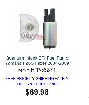

Wow that seems almost too good to be true. Has anyone tried this and how has it worked out?
I just got back from riding all day and the whining is still as loud as it was before if not worse. If there ever was an opportunity for some preventative maintenance this looks to be it

Wanted to update:
Ordered the pump, I installed it today. Very smooth/easy install. Fired the bike up and runs normal so I guess I didnt screw anything up. The high pitch whine is gone! If anything goes awry Ill report back
I noticed that the filter comes off rather easily from the OEM pump Im surprised theres no replacement part just for that

Cliff, (or Admin), as this fuel pump obviously fits (is a good brand name too), perhaps either make this thread a "sticky" or post #7(with the pump link) at least somewhere.
I don't think there's a non OEM fuel pump posted anywhere (W/O major searching)…
Thanks..
IIRC the electrical section has a sticky; where you bought your parts. I listed a bunch of fuel pump parts that interchange.
I would add it there.
