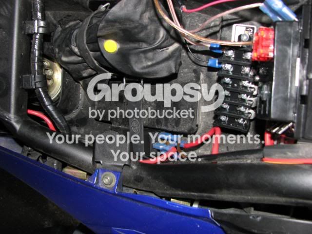

I put in a marine grade(SS) power distribution block wired direct to the battery (extra insulation around the main wire-NO FUSE). Got it from West Marine.
It's velcroed inside the rt side fairing. (commercial grade velcro)
One side is Hot, the other side negative. Once a wire come off the block to go an accessory, its fused.
I use "Posi Tap" in line fuse connectors:
( Order Online- Discounts )
and attach the fuses where their still accesable. In this configuration, ALL the top contacts are hot ALL the time, the lower side of the block is ground.
For the GPS hook up, I wanted it to go OFF with the ignition(switched). That line is tapped into the front right directional running light..The ground does go to the low side of the block.
I have my left side BMW style outlet, Stebal horn (thru a relay), etc, attached to the block
As for any accessory with extra wire that can't be trimmed (my Speedohealer, top speed indicator line), I wrapped it in a circular, tight wrap, used small zip ties and tucked in neatly in a recess adjacent to the lower, left side under seat tool area (actually, you can see part of it in picture #4, just above the BMW style electrical outlet-to the left of the pillion peg mount)...
The heavy line in the first photo, on the left side, runs separate power lines (already fused) inside the fairing to the other side of the bike for the horn and further back to the outlet...

This is how mine is setup. Fuse at the battery, with the wiring running to underneath the seat. There I have a standard five point relay switched by a wire tapped into the tailight wiring. The 12V output from the relay goes to a fused dist. block (bought from a towing supply store), negative is collected by a linked barrier strip.
It's not the prettiest, but it does work and it's bulletproof. Best part is, if you need to tap into power in an emergency, you just have to lift the seat. Downside is it's pretty big, and takes up some space. Good thing our underseat compartment is useless anyways.
Next time around I'm tempted to go with something like the Centech fuse boxes, a little pricey, but considerably smaller and cleaner. This ghetto setup cost me maybe $15 for everything though
