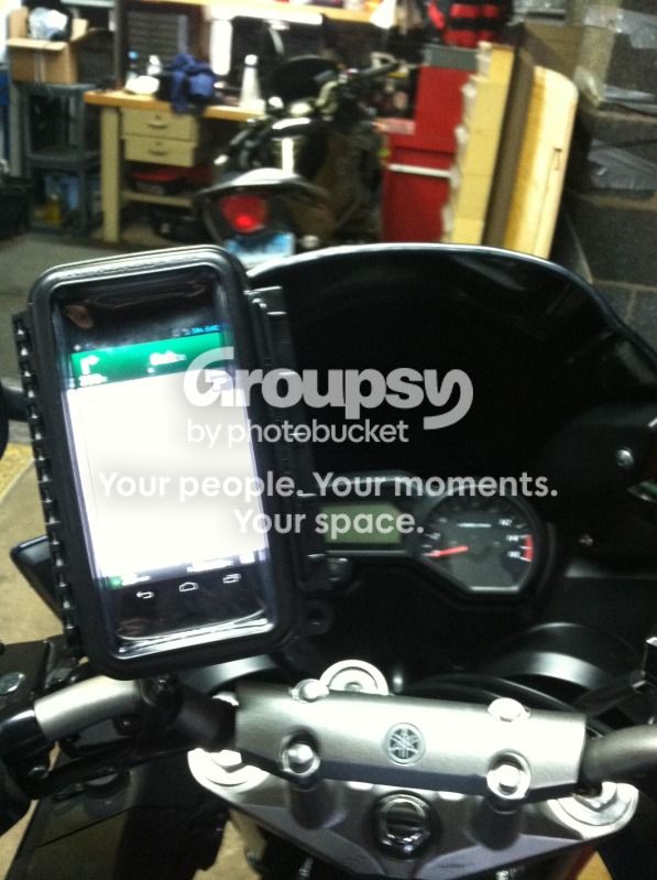

I used a battery tender connection off my battery to power my 12v outlet. gives me the functionality to use the battery tender plug in the winter which I really like.
OP check out the aqua box system from ram mounts. I just installed mine today and it's really great.

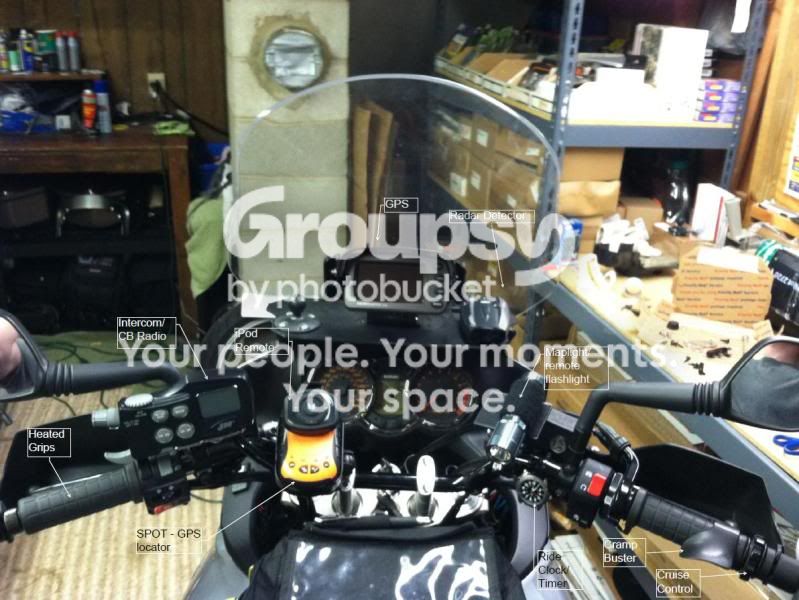

Garmin 2720. Wired into fuse block. You can pick up those GPS's all day long on Ebay for 100.00. Waterproof and shock proof. Garmin doesnt make them anymore but they still support them. You can find craddles and ram mounts to get it on the bike and wired in and still be out the door for less than $200.00

12volt marine socket straight on to the battery with an in line fuse mounted on the fairingblack panels behind the screen
Givi satnav waterproof bag and a 5" Medion satnav attached to the handlebars and visible behind the tank bag
