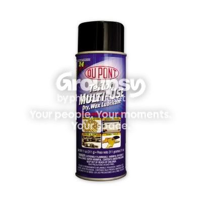

I have used this stuff since 1 mile on the bike and now at 18,xxx miles the chain and sprockets still look new! No sling off at all.
I clean with Kerosene, then wipe with a rag, then apply WD-40 to clean off the residue loosened by the kerosene and after a rag dry off and a short ride on the WD-40 chain I apply the DuPont and let it air dry for a few hours before riding.

FYI - I was sold on this product after reading some reviews but alas, it has been discontinued.
See background here:
DuPont Motorcycle Chain Lubes for 2012 - webBikeWorld
And a direct review of the chain saver:
DuPont Teflon Chain Saver - DuPont Teflon Chain Lube - webBikeWorld

It isn't discontinued I just picked up a can at Lowes and they had plenty. Oh I see now that they changed the formula.

Yes my brief research tells me that it has been reformulated. It's basically the same stuff but now does not include the "dry, wax" portion on the can. This makes it less desirable. The DuPont chain saver product is supposedly the next best thing.
