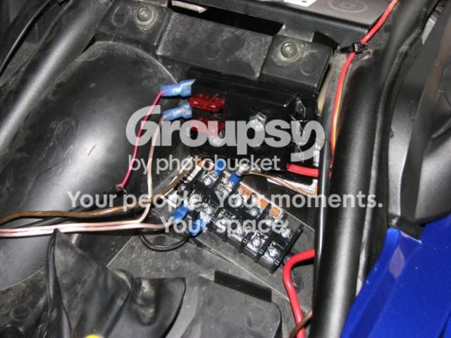

I've been wanting to add a few extras on my bike but need to figure out a way to wire it all. I've been thinking of a fuse block or something similar.
You can build your own auxillary fuse box for under $25, or buy a premade one for <$50. Premade, the Centech and Fuzeblock units are nice, Motorcycles FUZEBLOCKS.COM.
I made my own. Standard five pin relay provides power, switched by the tailight. Simple six point fused block provides positive power. Jumped barrier strip links the grounds. Not pretty, but it works and I never have to look at it.
