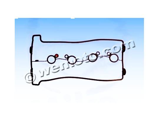

Do you change the rocker gasket also when you open the valve cover?
Or is it reused?

I did take the throttle bodies off, don't know if it's needed, but mine were pretty much welded on, took a lot of prying to break them free. Reused the valve cover gasket as well, meant to order a replacement, but forgot. No leaks since thankfully.

Just checked mine yesterday at 42k km. All were somewhere in the middle range of the spec, no throttle body removal needed (loosening the radiator and removing the cooling fan gives the extra space needed to remove the valve cover) and I think the whole thing took about 3.5hrs total without keeping much hurry and changing the spark plugs at the same time. I reused the valve cover gasket as it seemed to be in a good condition.
