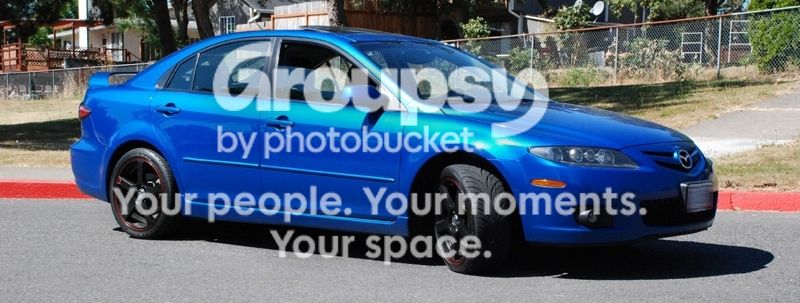

I've got an 06, Mazda 6, V6. 6 spd ATX, Grand Sport Hatch. Its damn fun to drive! Even with cheap tires that came on it, it sticks well in the corners!:rolleyes: Who knew a Hatch would be so fun to drive! It's coming up on 100K fast. A year ago 70K when I bought it! I like it!
If I didn't end up stuck in 10hrs of traffic a week, an MTX would be sweet. I do miss my rear drive V8s tho! Nothing better the stepping the back out around a corner! :thumbup:
As stated, anything NEW has so much BS its crazy. Only thing missing from the 6 is navigation. Since this pic the windows are tinted and im prepping some Acura TSX HID projectors for OEM HID replacement as they scatter light everywhere. The TSX projectors have a real nice cut-off.
