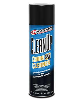

Re the cleaning the chain. I wouldn't remove / re-install/soak the chain. Just way too much to do when better results can be obtained using a specific chain cleaner. I use Maxima chain cleaner (MC specific): https://www.maximausa.com/product/clean-up/ . I'll use it 2-3 times a year, tops along with a grunge brush (aluminum version). The chain/sprockets are spotless of all crap and ready for lube.

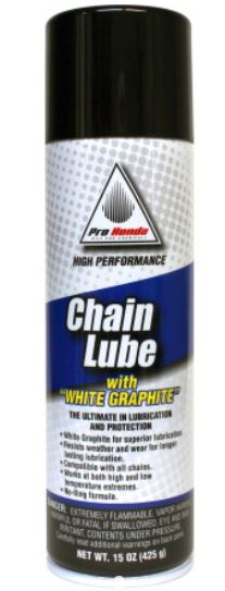

Lastly, chain wax IME is junk and should be avoided. I tried it on another bike years ago and had RUST coming from the rollers. Stick with a petroleum based lube. I use the below pictured lube which sticks very well and holds up the best I've tried. I do lube the chain way more than required (approx. 200 miles) and it shows..
Re-check the tightness of the chain and if using wax, pitch it..

I have been using the Honda pro chain lube all along.
