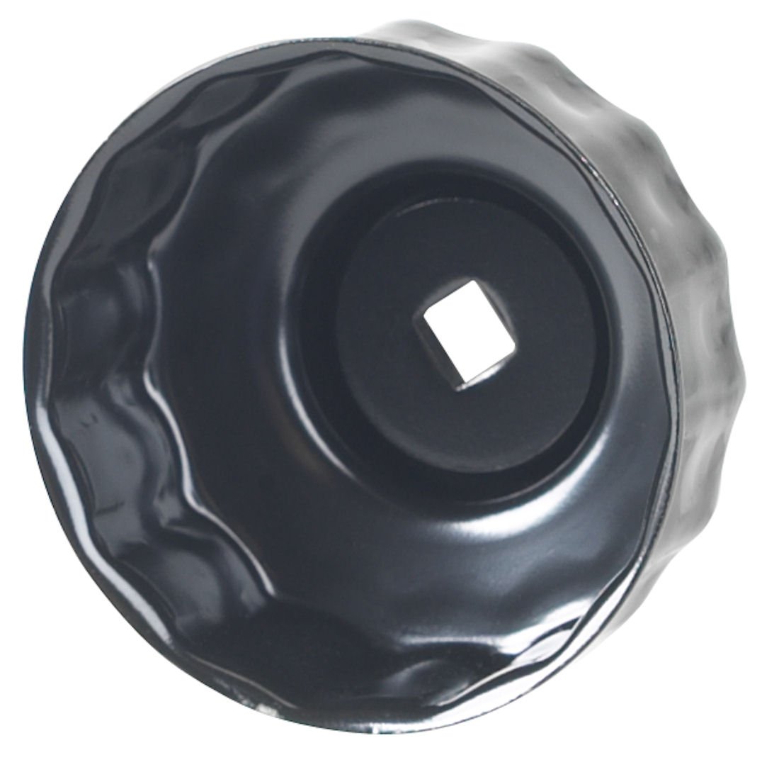

as much as the big plastic filter wrenches are normally useless, I found that if you 'shim it' a bit (I used some old business cards) such that you have to tap the wrench onto the filter with a hammer, it had more than enough grip to remove the filter with a good sized socket wrench.
That said, like many, I went to the K&N filters with the nut welded onto the end. MUCH easier to deal with. Which reminds me, I'm due for an oil change...
