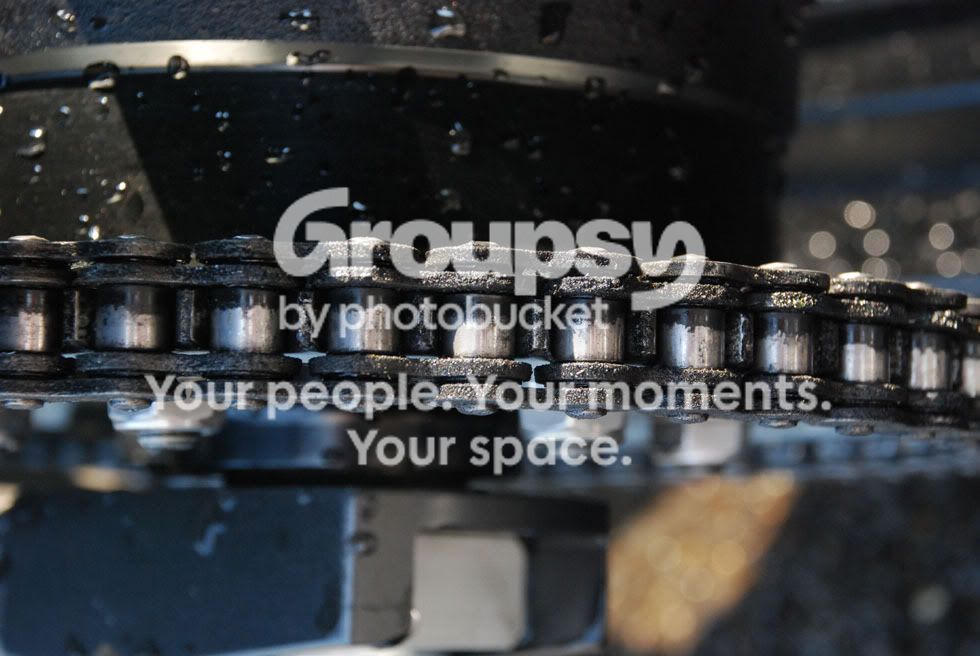

After a 200 mile ride I saw a consistent contact pattern on my chain rollers that indicated the rear wheel was not centered as perfect as I thought it was (see picture below). According to the contact pattern on the chain, it showed that there was not equal loading across rollers surface. This made me question if the rear wheel was aligned properly. Previously I'd used the hash marks at the adjuster and some veneer calipers to measure from the wheels edge to the swing arm on both sides. The marks were on and the calipers showed an equal distance to the swing arm. Sadly, this doesn't mean the wheel is aligned to the bikes frame and front wheel.
There is an explanation for the pattern shown. Because the chain pulls from the top of the rear sprocket and the greater contact patch is on the left outer edge, it implies the rear hub may be turned to the right. Because I'd taken a good deal of time to get it right the last time, I needed another way to verify if the rear wheel was aligned to the chassis properly.
Take a look:
Because the chain gave me hint, lets find another way to check the rear wheels alignment.
oh that's about 550 miles since last cleaning and lube and it is due right now. Luckily, dirty chains tell stories! :)

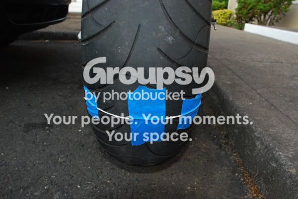

  • With a large chunk of tape, find the center of your string and tape the string to the rear tire at about 5-O'clock position as viewed from the right side of the bike. The string will go around the back of the tire and both ends will head to the front of the bike through the center stand.

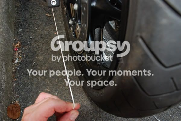

  • Now pull the string towards the bikes front disc (rotor) avoiding touching the center stand (rotate rear wheel to achieve a nice working height). The goal here is to watch the string as it just "barely" touches the leading edge of the rear tire. Do this by moving the string closer and further from the front disc and just as the string touches the leading edge of the tire, you have a straight line revealing the thrust angle of the rear tire.
  • Notice the distance between the disc and the string. Measure the distance and write it down on paper. If you have veneer calipers, flip them over and use the long slide to measure with.
  • Repeat on the other side and compare the values recorded

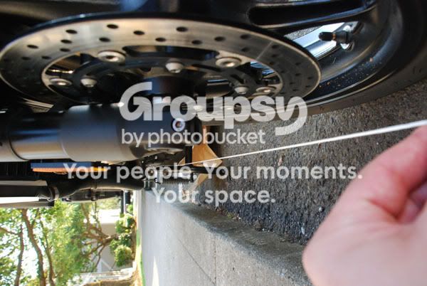

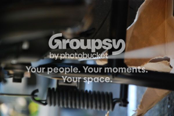

Tape the string to the tire like so! Hint - blind cord is thick and white, easy to see and handle.

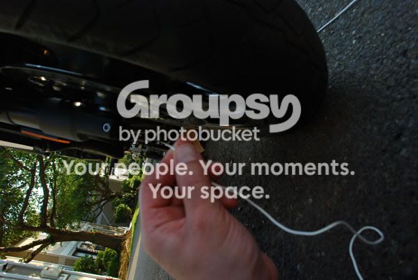

Rout it through like so!
Avoid touching anything but the rear tire!

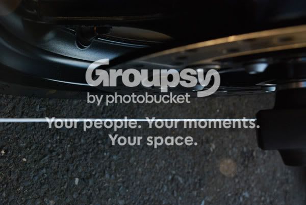

Eagle Eye the string. Just BARELY touching the rear tires edge!
Determine the distance to the front disc. Measure and compare to other side!
The other side! These should be the same distance!
