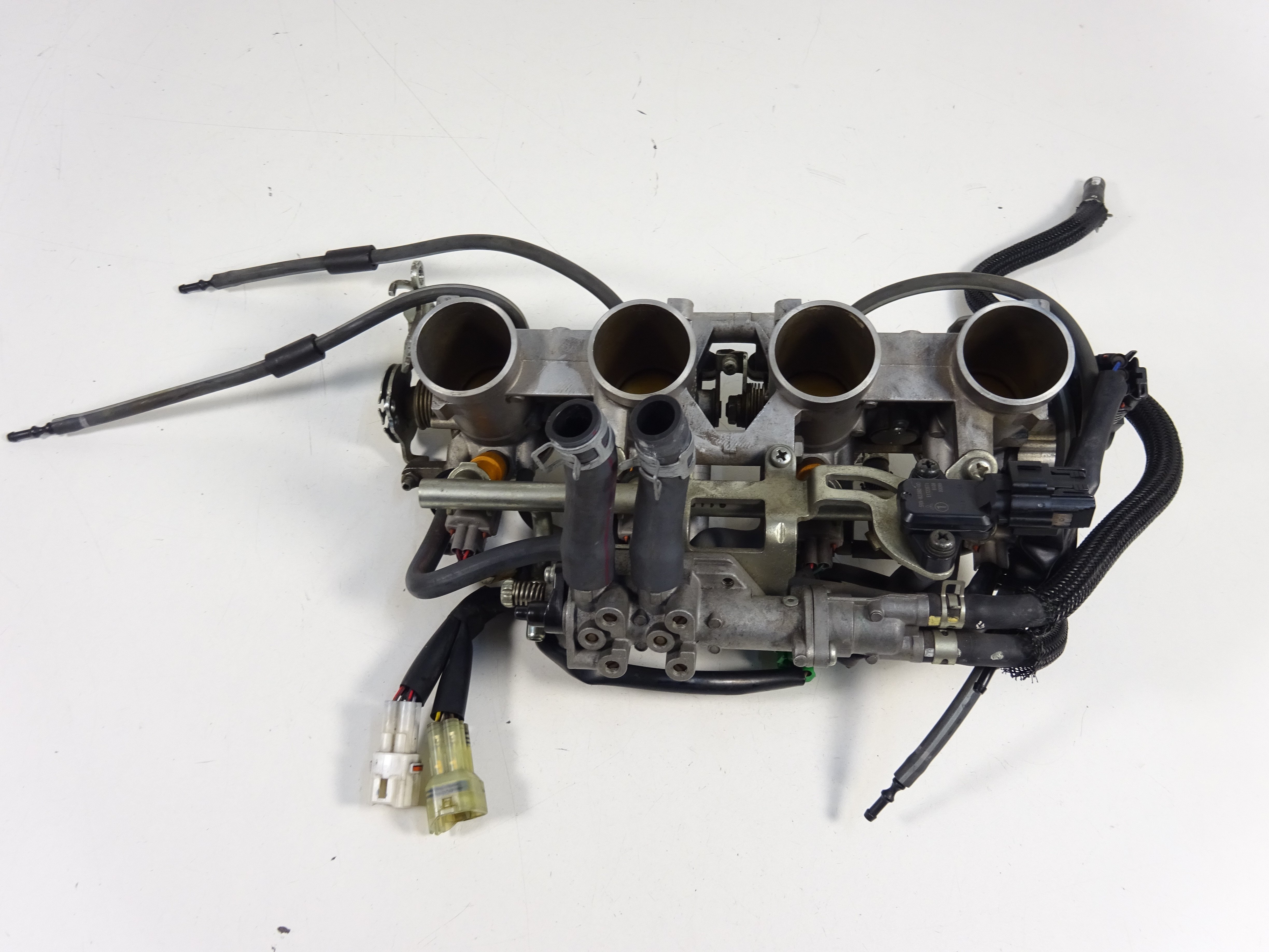

From the car battery i will get around 12.1 12.2
It starts nice and also have good idling but when i rev it drops if i spam my gas like close throttle open close open close it will be get higher and bloks. The rpm it stutters or something.
See video
Tested all fuses it fine.
If its starter relay i will buy it tomorrow!
I got scammed with this accu lol i need a new one but until then i can test it with my car battery.
I also tested with a home made dumb pressure gun see picture below lol it works with gas. I put some fresh gas in the bottle and push it to the injectors then the bike runs and revs then very good.

I'm a little confused... The video you just posted looks like you have poor fuel delivery.
I thought we were trouble shooting fuel system voltage problem.
Now it seems you have lack of fuel delivery. The fuel pump or filter could be clogged or you could have low voltage to the fuel pump.
You should establish what voltage is at the fuel pump. If the voltage is not good you should find where the problem with voltage is.
If the voltage is good then there is a fuel problem. From this last video it would seem you are not getting enough fuel to the injectors.

Thanks for you answer!
The fuel is clean and filter is also clean but i think i have put this ring on the other side.
I will check it en test it again

Guys i think i found the problem. I changed this pressure regulator and it revs like a beast.
Didnt rev too much because my babe is cold.
Guys Thanks for all your support and respons i really love you al and if i can do something for you guys please let me know

Guys I changed this pressure regulator and it revs like a beast. But while riding it was first 15 minutes fine but after its stutters after 4k rpm but it works fine until i reach 4k rpm
BUT i can drive low rpms its better then not driving lol
Round 4k rpm i reach 14.04 volt on my battery.
I really was hopeless until i drove :)
My bike runs but high idle til 4k rpm somes it goes higher but mostly it stops at 4k rpm.
I got a repair option at my battery charger. Wil repair it and after that charge it to max.
And test it again or should i buy fuel pressure tester?

I sounds like your not delivering enough fuel volume. Great that you're seeing a difference now.
Do you guys know how many bar/psi i need on the pressure regulator?
This new one is 3 bar. And some websites like ebay they sell 3.5 bar for fz6.
The question is after 4k/5k rpm sometimes until 8k rpm but after it works fine.
Maybe i have to buy the 3.5 bar idk.
Btw the fuelpump is 12.4v in the diagnostic mode.
Euhm what should i do?
Cant see how many bar this old pressure regulator is..
