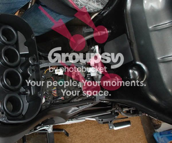

Take a look at the pictures in this thread. http://www.600riders.com/forum/showpost.php?p=579362
Inside the tank.
FZ6_FuelTankVents_zps541edea1.jpg~320x480
12,533
1,180

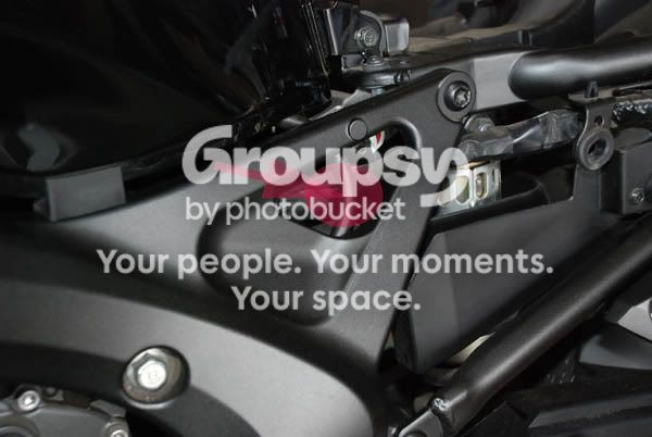

With the bike on the side stand and the gas cap open, you can see the drain on the left side(looking down from the top), that is the drain should you over fill(you can see the holes thru the cap assembly. The rear, with the red seal is the vent.
The pic Randy posted is my spare tank with the pump out showing each of those lines

BTW, both those lines, at the bottom, have a white stripe of paint on the bottom. They should exit on the right side near the O2 sensor. There's an actual plastic round piece the hoses go thru to keep from flopping around.
As Randy posted, they shouldn't be kinked (it'd screw up the test too). You can easily, follow both rubber hoses down from the tank (bike fully assembled) (I touch mine with a finger and tug feeling the line so I know I'm on the correct line) and gently tug on the lower end of the hoses. The left side hose should track off from the left to the right side and go into that plastic retainer.
For the S1 bikes, the radiator overflow line comes out thru there as well (3 lines). Your should see two if the lines are routed correctly.
Just a larger, easier pic to see:
In this pic, you can see the two lines(holes for venting/draining and 4 bolt holes for the cap. Again, one bolt is UNDER the open cap. The six bolts showing on the outside, 3 work, 3 are just for looks..

As begin to drop the tank down, reach though the frame rails and pull the tubes back on both sides so the tubes don't bunch up under the tank and get kinks in them!
Reach in here; Pull vent tubes towards the rear as shown!
They should be visible though the opening or they may be kinked under the tank!
DON'T let this Happen!
That's it! Pay attention to details!
