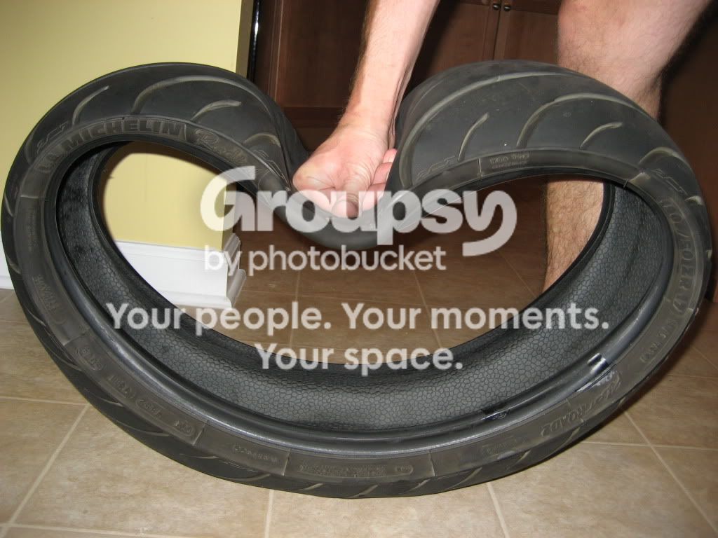

...are your $285 pair of michelin pr2 ct's supposed to do this? since putting on these tires, ive spent hours chasing demons that i thought were in the suspension and bearings on my concours 14...it was the friggen new tires. it literally was like trying to ride in a bowl of jello! since im familiar with shinko 009 ravens, i put a set back on and the bike handles like the day it was new.

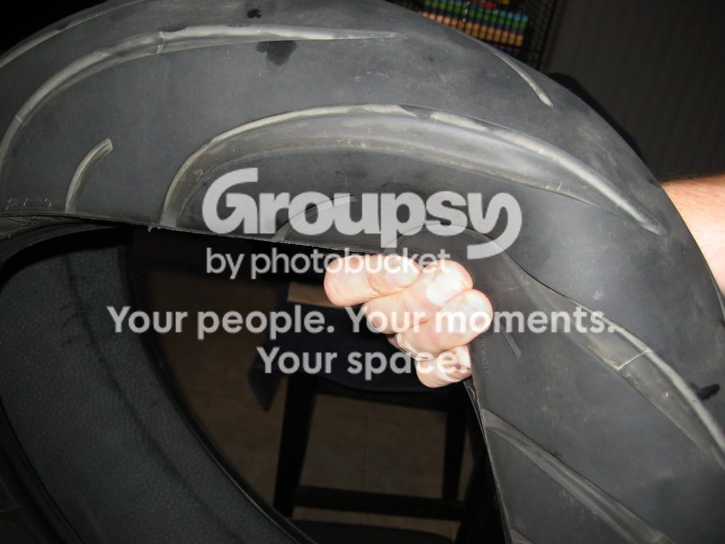

im merely squeezing the bead and the whole tread collapses
im pushing with one hand...and not very hard
you can practically wad these tires up with one hand. they were not this loose when i mounted them, but progressively got softer over 400 miles. the date codes are 3009, made in thailand, were purchased in jan 2010, and stored under my bed until august.
i have contacted michelin and they are going to call me back with further direction. my tire dealer has also passed this on to his peeps.
discuss...

Edit: just saw the pics:eek: Nah! That aint right! :spank: WTF!?

ive used this model tire before on the c14...as has half of the concours owners group. they were absolutely fantastic and are the tire of choice. but not this set!
michelin rep just called me. they are sending me shipping tags to send the tires back to them. he spoke with his tech people and they stated they havent run across this issue before. still to early to speculate...

thats the problem...they wont hold a straight line to save your life! its like someone was grabbing the tail of the bike and shaking it as youre riding. highly unsteady straight and in slight curves...like being stuck behind the worst truck wind wash, but with no wind or truck! hard cornering was surprisingly ok...but not a sure footed as my last set of pr2's

I worked at a tire shop for 3 years and I can tell you that michelins have the softest side wall of any tires. You can do what you did in the second picture to pretty much any of thier tires. I'm talking about car tires here tho.

+1 on the car tires. Worked in a shop for several years and michelins were by far the softest sidewalled tire out there. Also, they had a weak belt construcct - even a little excess heat from low pressure would cause them to separate like crazy. Don't know about m/c tires though.

Michelin has soft side-wall and what you showed on pictures was normal.
I suspect you didn't had enough tire pressure when you were "chasing daemons" after instaling PR2's. They are quite sensitive on tire pressure (because of soft side wall).

chunky, ive been using michelin tires for a long time. ive been using the pr2's for the past 25k miles or so. none of them, ever, could be folded in half like that. not even the brand new ones on the showroom floor of the bike shop...of any michelin model or brand.
on that note, the tires went back to michelin saturday via ups. they sent me labels to ship them back.

after five months worth of emails and unreturned phone calls, michelin CALLED ME and have informed me, with great enthusiasm, that my tires are perfectly normal. im not an engineer, nor am i a compound scientist, but i disagree.
because the tires are without fault, i can 1) take them back and be a satisfied customer, or 2) get a PARTIAL credit (remember these only had 400 miles on them) towards another set (so i lose money there).
