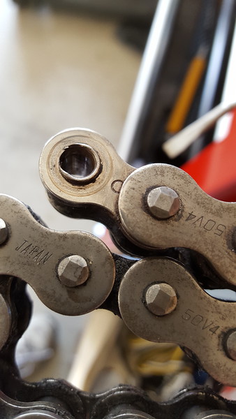

I got 45k miles on my original chain and sprockets. When I replaced with OEM chain and sprockets I was able to get a Master link from Yamaha dealer so that I could install the chain without removing the swingarm.
Now, 25k miles since, my chain started clunking like it was wore out. Since it was OEM I expected it to last as long as the original. I thought maybe I didn't lube it as much as I had the first chain but upon further inspection I determined the noise coming from the Master link going over the counter shaft sprocket.
I removed the master link and found the problem...
somehow the master link was wearing through the chain more than any other part of the chain. Actually the chain appears to be in fine shape except for the ends.
I thought about removing the bad links at each end and getting a new master link... but that would make the chain too short.
With 25k on the current sprockets I don't want to install a new chain on them... so replacing the chain AND sprockets is the only option left.
This time I won't use a Master Link.

I do get pretty good mileage compared to what others report, true!
I put the new chain on today without splitting it. I actually searched forums and YouTube for info from someone who had done it and found nothing. seems everyone was splitting and rivitting the chain. It wasn't that hard though...
ready to pull the swingarm bolt...
I almost thought I would have to remove the swing arm entirely (by removing the exhaust in the way) , but I avoided that.
once you pull the main swing arm bolt out, and remove the bottom shock bolt, you can twist the swing arm to make just enough room to sneak the chain in there.
I know, it is dirty in this area due to leaking seal at the countershaft... I fixed that today too
all done.
