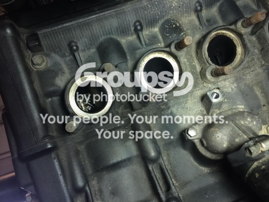

Im sure the damage is beyond repairable, at least cost wise. He took it to the shop this morning (against my advice) but we should know what the deal is this evening. I have one pic of the exhaust port, and you can clearly see the scoring on the head from the valve bouncing around
