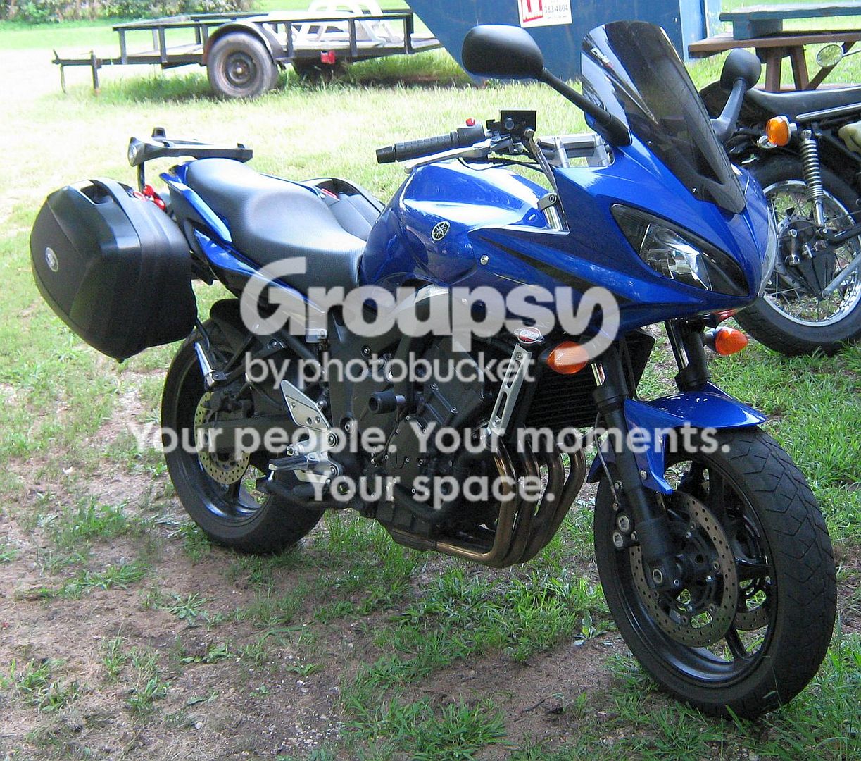

I went a little overboard when trimming, and if you look closely you can see a bit of blue fairing that's about 1" higher than the top of the screen.. It bothered me at first, but I've learned to live with it.. I knew better, too.. I always take my time when trimming down screens I'm cutting and set them back on the bike before sanding more plastic off..
I just went ahead and rounded the corner and then saw I went too far..:( Oh well, you can't just add it back, so I finished it at that height..
I'll get a used/abused stocker one of these days and trim it to the right height and paint the interior black..

How do you like the shorter screen? I have the same one but not cut down.
I like the short screen, but the double bubble is still tossing air at my base of the helmet. I've found that if you can get the screen to throw air at the base of your neck, your helmet will be in clean air (quieter) and it allows the venting to work as designed.
From what others have said, the stock screen, cut down, will get me what I'm after.. Please remember that we all sit differently on the bike and some of us have taller or shorter torsos, so height can vary as far as what's needed to do the job.

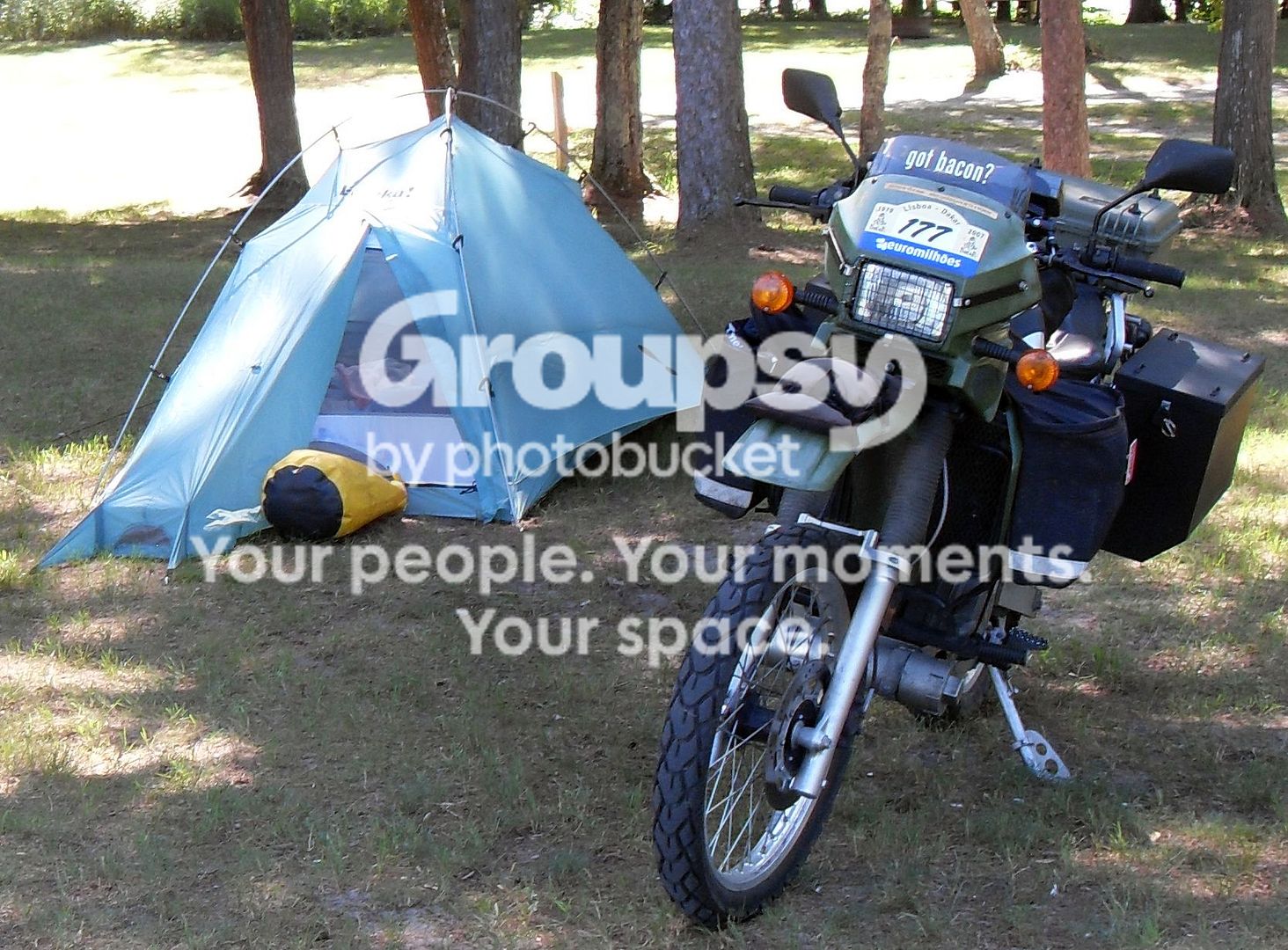

I learned the trick from my KLR. The Gen 1 KLR's have a "flip" at the last 1 1/2" from the top of the windshield. I first tried riding without the screen and found the windblast at mid chest wasn't working.. So I cut the "flip" off and found it perfect for me.. Many KLR riders keep going to taller and taller screens to get rid of the buffeting, when all that's really needed is making it a little shorter.. After riding my bike, most of the KLR riders I know have cut their's, too.
My KLR after cutting the screen down.
Factory screen.
I figured the FZ would be similar. My bike (purchased used) came with the full length Puig screen and it didn't work for me.
So I trimmed it to the height shown on the other photo a few posts back.. As I mentioned, I'd still like it a little lower, so I'll find a sacrificial stock screen and see what happens. :thumbup:
