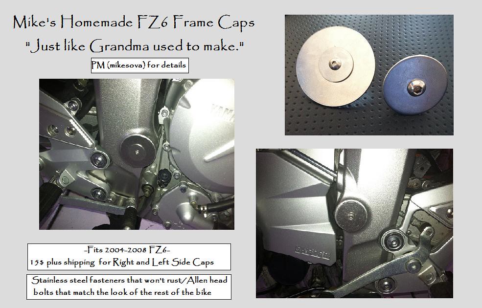

While I was scanning the interwebs, I came across some frame caps that somebody was making and selling. My family owns a hardware store, so I figured I could duplicate them pretty reasonably. You be the judge:
I just used stainless allen bolts, fender washers, and some rubber well nuts.
