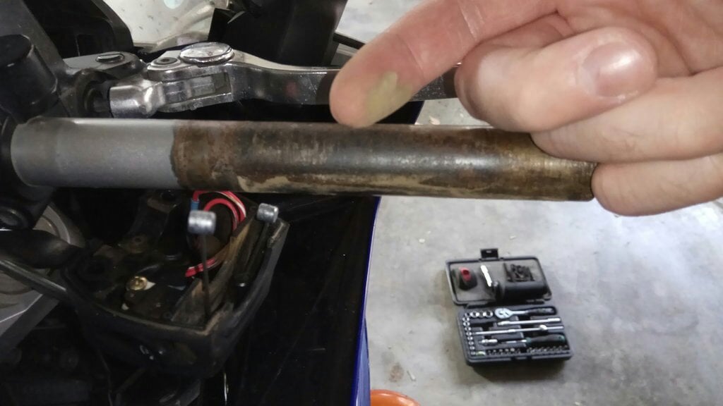

Hello,
You also might try removing the throttle tube and cleaning underneath, dirt can get in there making the throttle harder to twist.
This is a picture of mine before cleaning;

Hello,
Good idea, I will keep this in mind. Certainly possible. Thanks.
