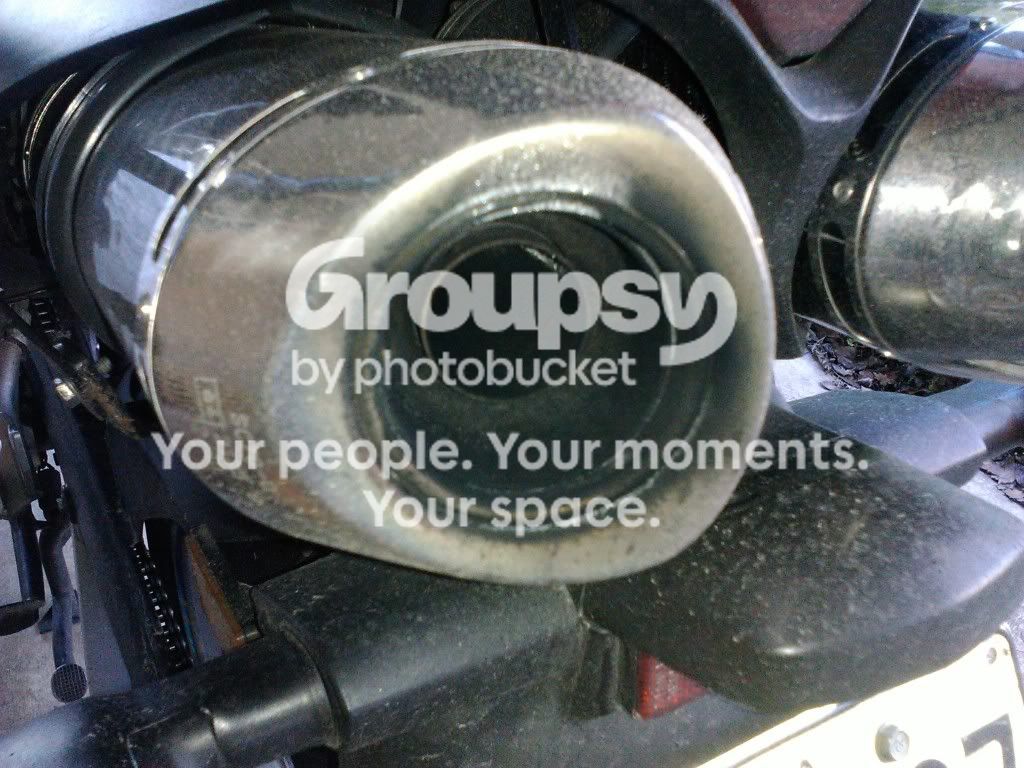

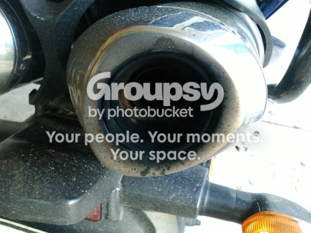

One thing I've noticed, pending getting this looked at.
I fitted my nice clean Scorpion pipes, and look what's happened to the!
Now, my bike only has 35000kms on it!
Is it me, or is it running uber rich?

My Scorps (no DB killers) don't have any black soot on them like yours do. I don't have a Power commander either, stock ECU. And yes, that appears to be "uber rich"
I assumming you didn't do a high speed run to blow the carbon out??
If that's from regular riding, I would likely be looking at your Power Commander, either the mapping or somethings wrong with it.. You may try disconnecting it, clean the pipes and see what happens..
As black as those pipes are, I'm surprised you can't smell the unburnt fuel coming out the back...
BTW, once you get the problem fixed, I'd run some Seafoam on the heavy side and give it a couple of good hard runs and blow all that crap out of the combustion chambers...

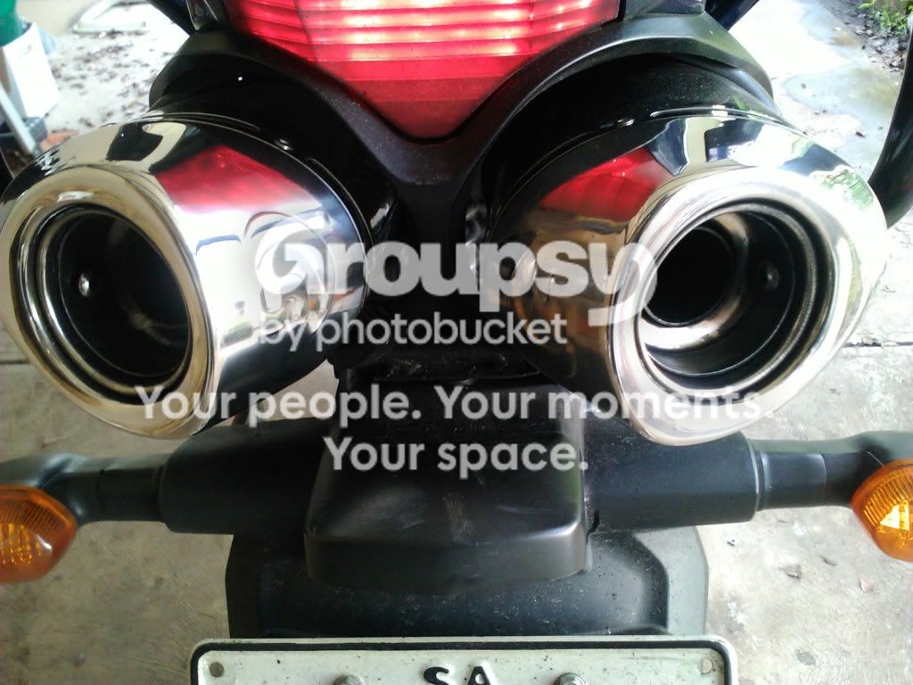

PC3usb removed - and now, the pipes look like this:-
I've been called into work, so let's see if they're still so shiny after 120kms tomorrow morning!

Just cleaned up, at this stage - I'm at work now and finish tomorrow morning (actually, it's been 'tomorrow morning' for 12mins!)
Anyway, they look nice and clean after 60kms to work, and no doubt they'll be just as clean after the 60kms to get me home.... (considering it only took 400kms to get them really dirty)
We'll see, but maybe, just maybe, the PC3usb was enriching the mixture too much. (I checked the vacuum lines when I pulled the PC3usb from the bike today (actually yesterday, now!) and all looked ok)
