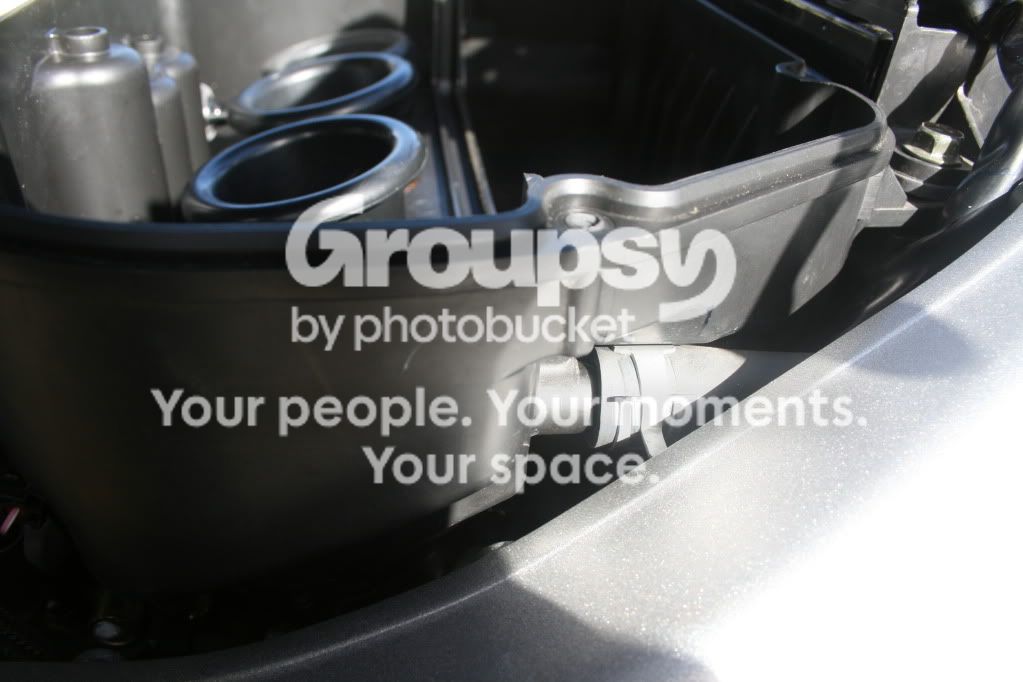

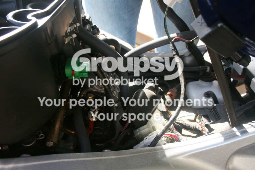

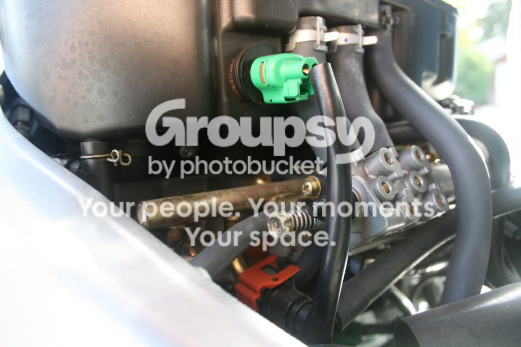

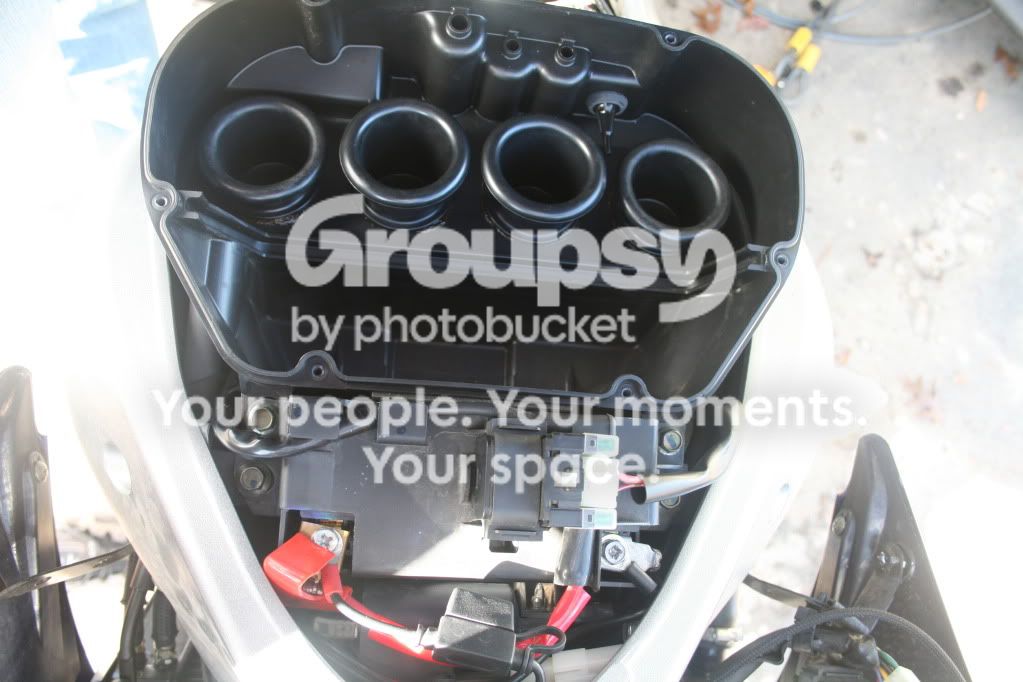

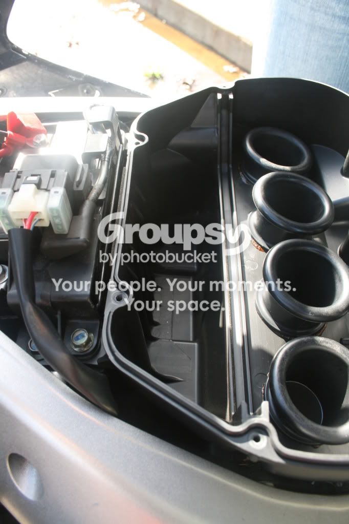

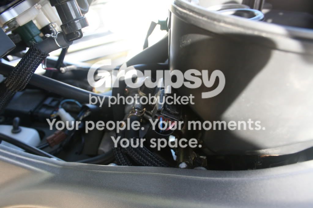

Okay, well I figured before I start taking the complete airbox off (properly this time) I would post some pictures to see if anyone notices anything out of place. Hope this helps.
Thanks for any suggestions!!!

Fred,
Well I went ahead and loosened all of the clamps and took the entire airbox off. The throttle bodies were very firm. There was definitely nothing loose under there. I'm starting to enter panic mode now because it seems like everything is more or less normal under there. I'm not sure what the problem can be. If you look at the pictures and see anything that doesn't look right please let me know. Or just tell me if you need a picture of something specific and I will take it. One thing: that green "plug" that goes into the airbox from the back seems really loose, I don't know what the deal with that is though.
Please, anyone who has a suggestion: HELP!!!
