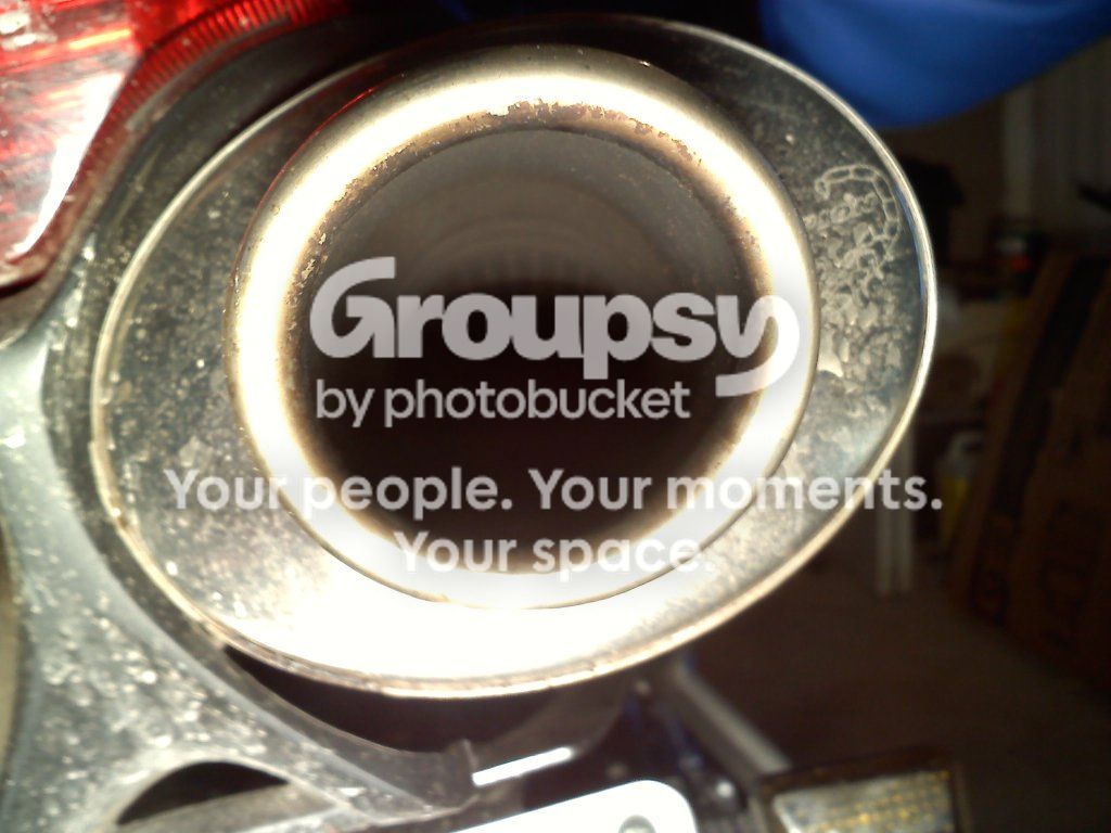

Can you take a picture of the inside of one pipe up close?

It's pretty loud at 8k rpm but I never rev it that far up in town. There's definitely nothing inside of them though. I guess I'm just used to coming from the mustang where it was loud even at 2k rpm.

Yea, their open.. You can see the threaded hole to the right side that's used to hold in the DB killer (if it was installed)..

Where are you seeing this threaded hole I've been looking and I don't see one..
The picture angle, at least for me, isn't the best to see the hole however it appears to me, there's IS a threaded hole, ON THE RIGHT, INSIDE of the INNER pipe, maybe an inch in from the back edge...
That's exactly where mine is as well. If its not, can you take another picture, from almost the same spot, but angled outward looking at the OUTER PART (of the inner honeycomb) of the pipe... Its a pretty small hole (an 8mm headed wrench would fit the bolt if you put a hex head bolt in there)
In either case, it doesn't appear you have DB killers in, so there's nothing else to pull out. The pipes are as loud as there going to be. As you noted, pulling the cat will likely make it louder however I don't know how much louder or if you need to do anything further to keep the bike running good. I've read of some irratic, idle issues with the cat out, but can't speak of it from experiance..
