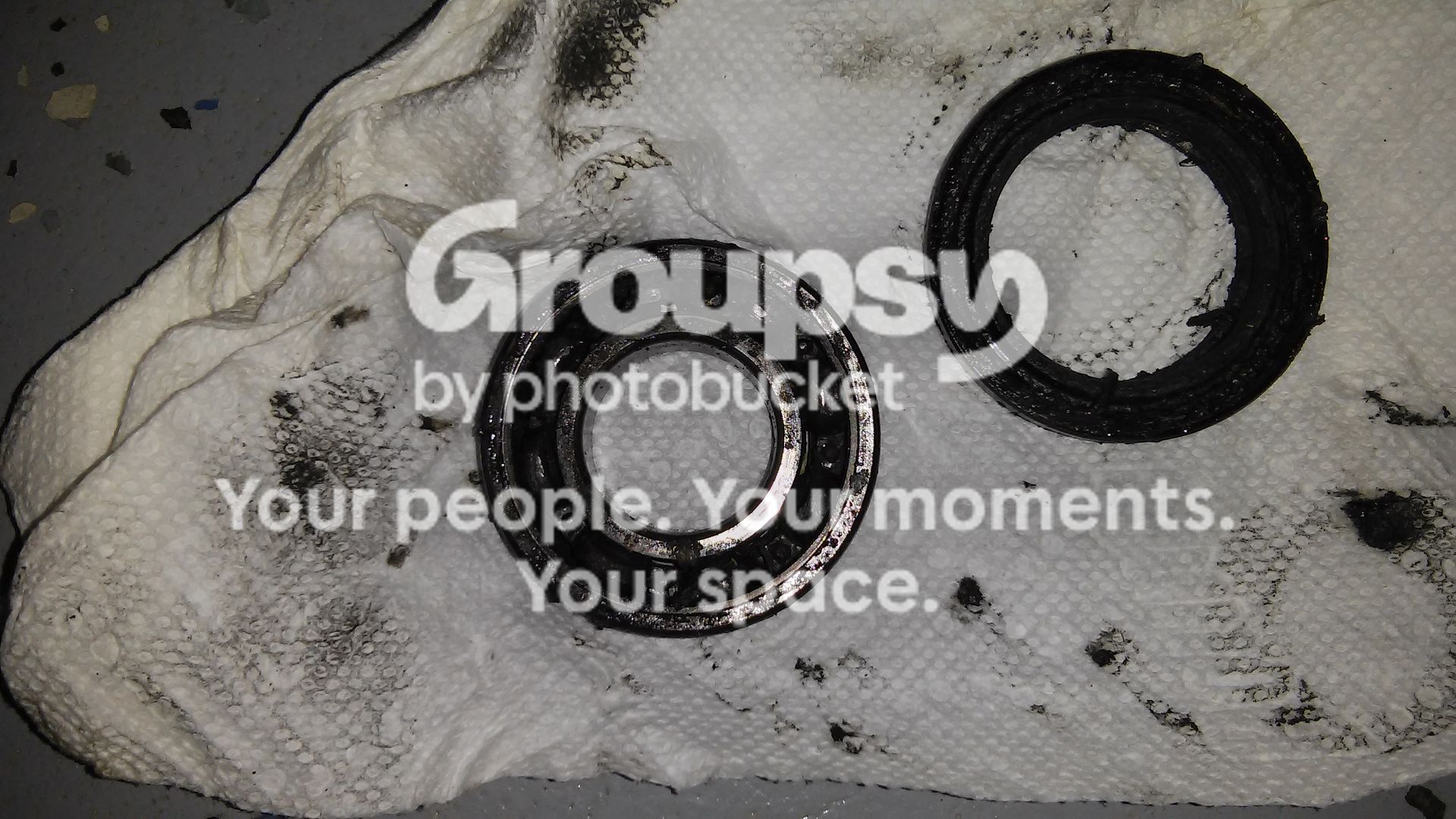

Figured I would update this almost a year later :rolleyes:. It turned out the sound I heard was a destroyed bearing. This was the first time I removed the rear tire since I bought the bike and looks like the bearing was held together by magic before I removed the wheel. The previous owner had laid the bike down on the left side and that clearly destroyed the rear wheel bearing on that side. Hopefully others can learn form my mistake/idiocy. If your bike has been laid down, replace you bearings!
