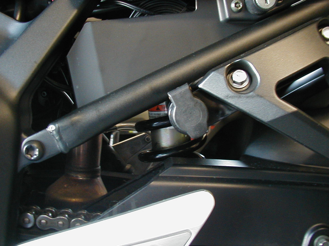

I have a BMW style outlet on the lower left side of the bike:
