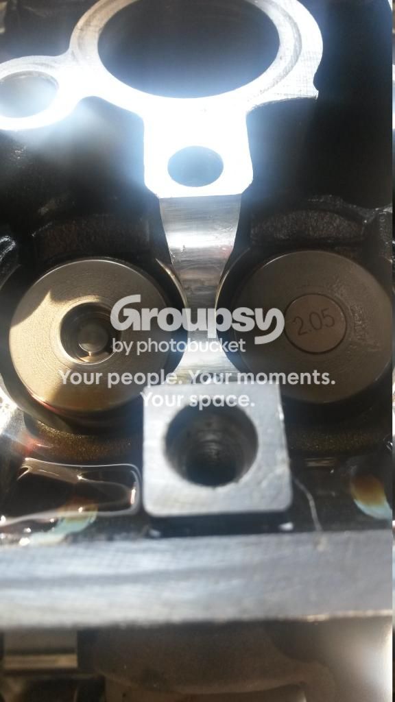

Installing the shims
New exhaust measurements with new shims:
1a-0.27mm 1b-0.32mm 2a-0.30mm 2b-0.25mm 3a-0.27mm 3b-0.30 4a-0.30 4b-0.25mm
I know I know 1b is over by two hundredths of a mm, but I'm leaving it! :spank: Nay say me all you want, I'm comfortable with it.

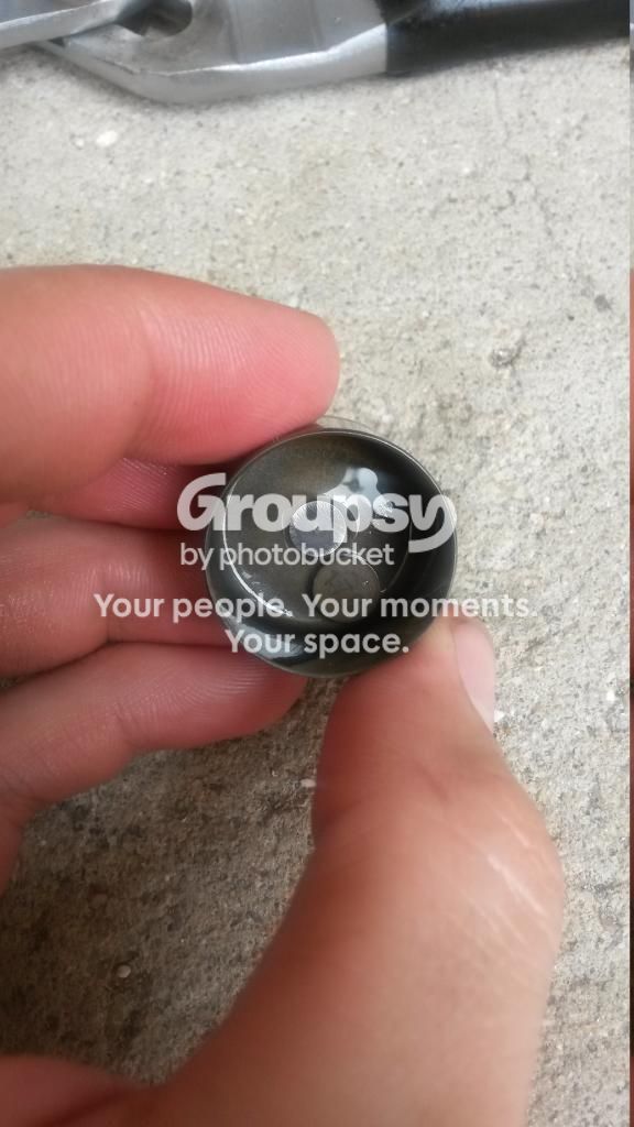

Thanks for the pic.
I didn't realize the shim sat inside the "retainer" (and no, I've never had to adjust the FZ valve shims yet), thus no stacking...
Makes sense.. :thumbup:
Yeah and the shims they gave me at the shop are pretty snug compared to the ones put in by the factory. I hope I'll be able to get them out if I need to for the next adjustment.
The shims sit in that recession and as you can see in this picture on the underside of the the bucket there is a raised circular spot that sits on the shim.
