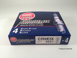

Updating this case finally found the solution
the main problem was...TPS
but also there were a lot of bad things here.
Bad spray of the injectors
I changed the 4 sparks because it was using a wrong code (cr10ek) and one was burnt :don'tknow:
Replaced by Iridium NGK
and finally it was using a car fuel pump so I put a new one :don'tknow:
replaced by this one -> Yamaha Direct Fit EFI Fuel Pump FZ R1 R6 Road Star YZF750R YZF650 1994-2015 NEW | eBay
Thanks to all :rockon:
