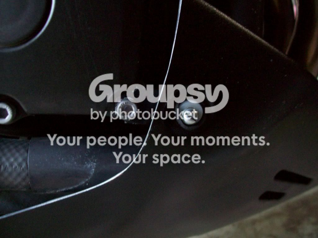

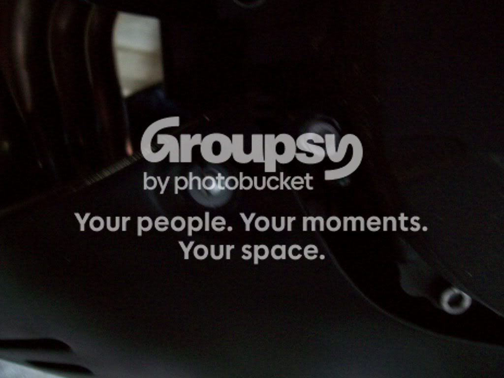

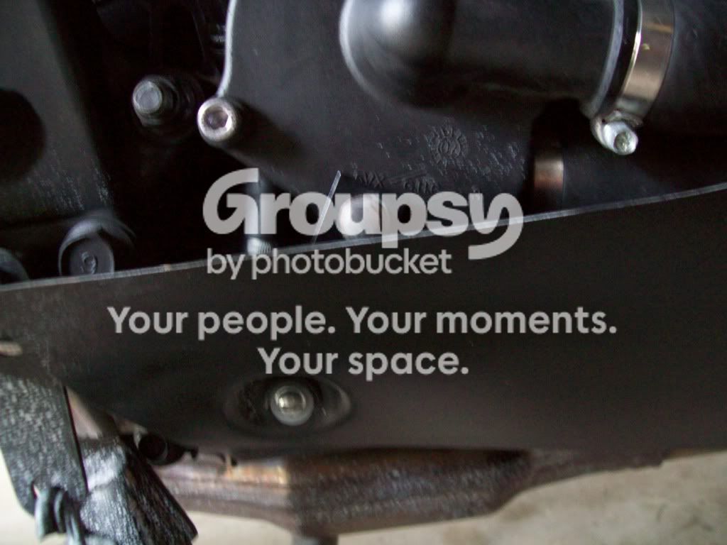

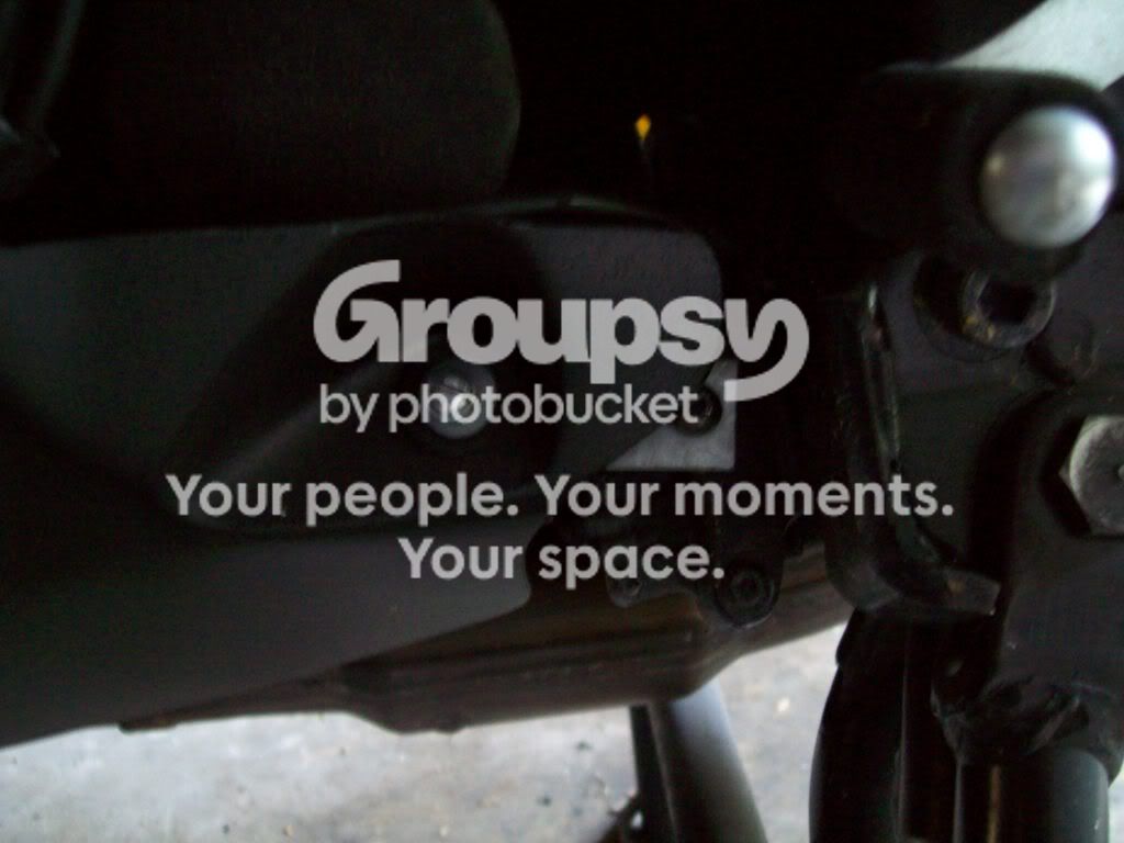

Sorry, I just can't seem to find all the pictures I had of the brackets and stuff. I mainly grabbed most of the info from HERE. There's pics in that thread of the mount points - I did my front ones just like those. My back left one is mounted to one of the kickstand switch bolts, it's hidden better and I imagine it was easier to make then the one shown in there. I'm thinking of making a new back right mount though, it's too visible when mounted to the water pump bolt. Anyways here's some more pics of the mounts:
Front right-hand side mount (lower right engine cover bolt):
Back right-hand mount (bottom water pump bolt):
Front left-hand mount (mid-left engine cover bolt):
Back left-hand mount (left kickstand switch bolt):
Hope these help - sorry it took so long - my camera sucks and it doesn't help that the brackets are (mostly) painted black..
