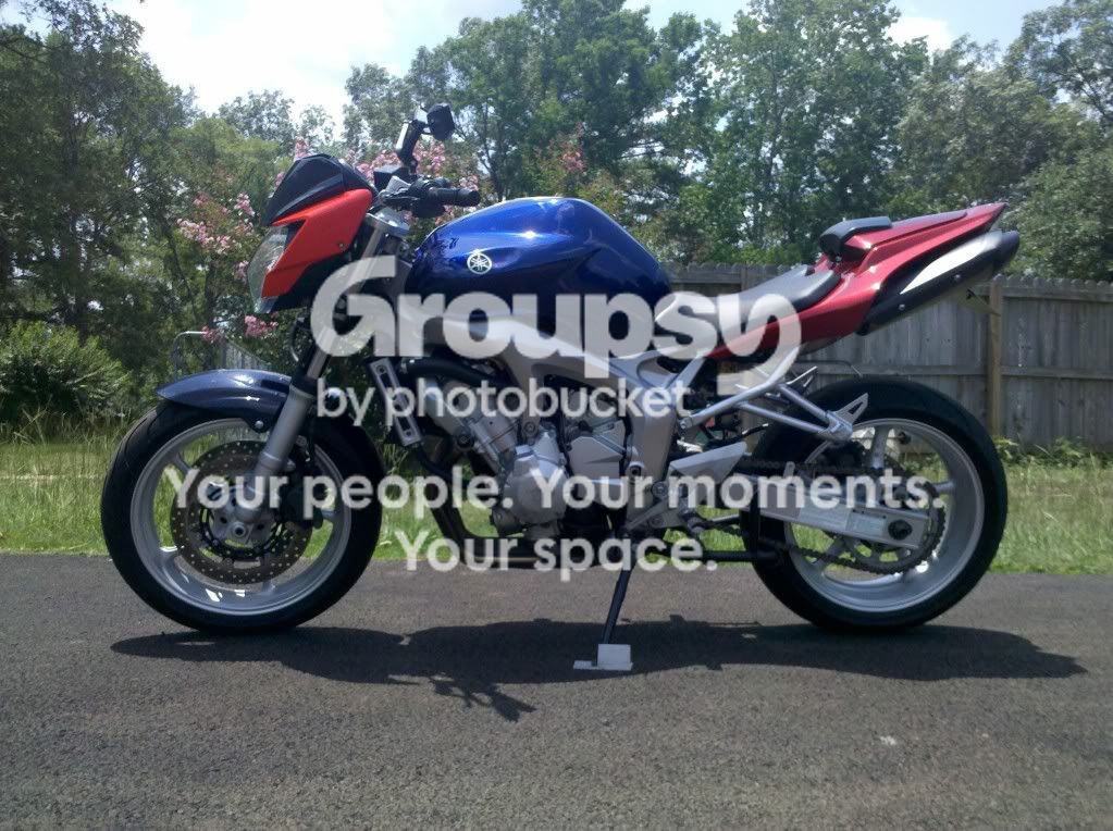

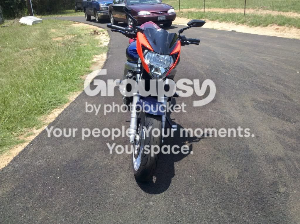

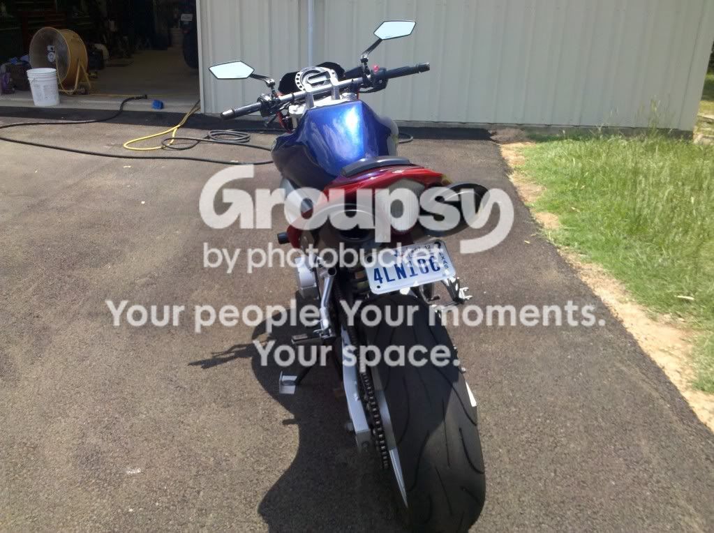

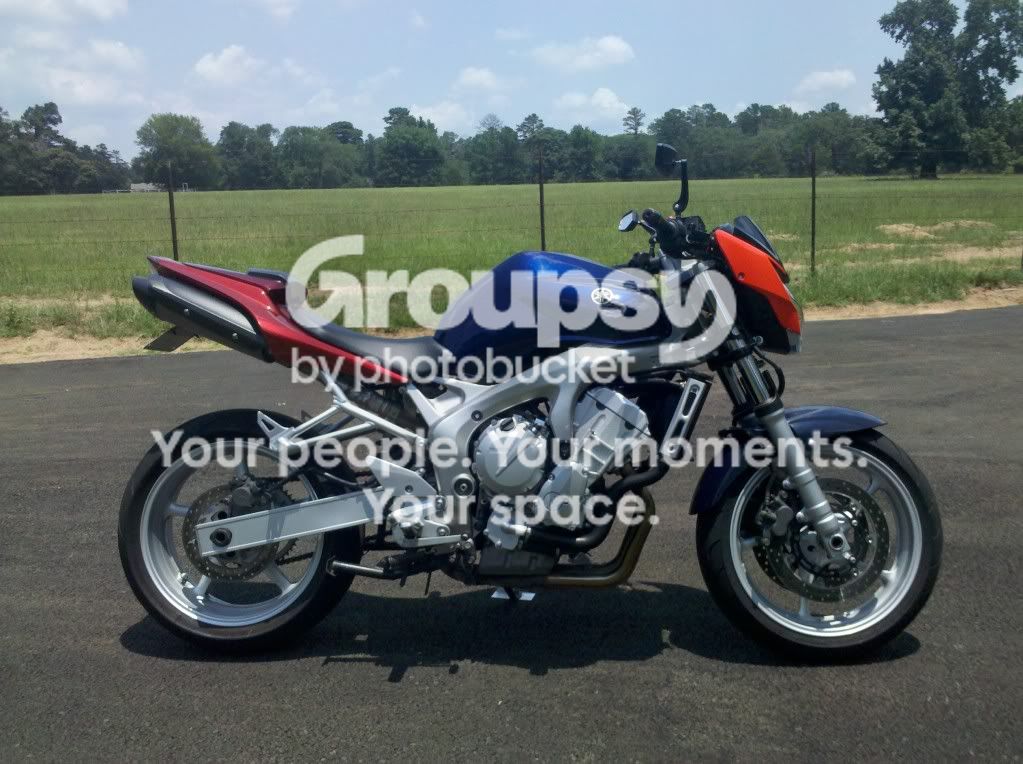

well the long process of putting the bike back to gether has finally wrapped up :D
the story:
the day after thanksgiving last year i went down in a corner and after weighing my options and seeing naked bikes like wavex's and a few others i decided to go naked. while i was at it i thought i may as well fix the things i dont like about the bike and this is what i came up with
complete 07 r1 tail
fz1 bars
r6 grips
2010 aprillia shiver headlight
i like how it turned out and its a blast to ride! and light!! 410lbs ready to ride!
anyways i plan on doing a how to on putting a complete r1 tail on a fz6 at some point so anyone thinking about doing this can be warned lol
more pics to come as it gets closer to bein done
Wow!!! I can't wait to see it all finished up and painted up, that's going to be one sick ass bike!!!
Wow. That does look great. How does it sound with the R1 exhaust? And are you gonna paint it like Chevy says? You don't like the Captain America color scheme?
thanks for the kind words guys.
no im not to fond of the captain america paint scheme. today took it all apart and sprayed it with plasti-dip to get it all one color.... i think that was a bad idea. looking at the individual pieces laying here im thinking its not gonna look to good. but thats why i used it in case i wanted to peel it off. i was planning on the plasti-dip holding me over till i get the money to paint it. i really like the red on the ducati 1198 and i will probably go with that.
as fa as the r1 exhaust its loud! the mufflers have race baffles in them to make it easier to cut them down and they were cut down almost 3 inches. it required fabrication on the subframe slip-on and pretty much anything behind the tank but the exhaust does slip on to the factory up pipe.
jresch10 i think i may use that name haha frankenfizzer....

i can get some close ups at some point of the exhaust but its really simple the slipon y then runs to each muffler. the mufflers were shortened about 3 inches (maybe 2.75 inches)
the tail is not really that hard to fit it just takes time and alot of thinking/planning ahead to fit it. its pretty much look at the mounting locations and build brackets to where you need the mounts to be. i'll do a write up on it if i ge the time. i took lots of pics of things you need to do to the subframe and such so people can see whats involved in getting the whole tail on
and seating position is good! the fz1 bars with fz6 seat was really good but this is just as good but different. i like how the seat is smaller and makes moving your weight around for corners much easier
