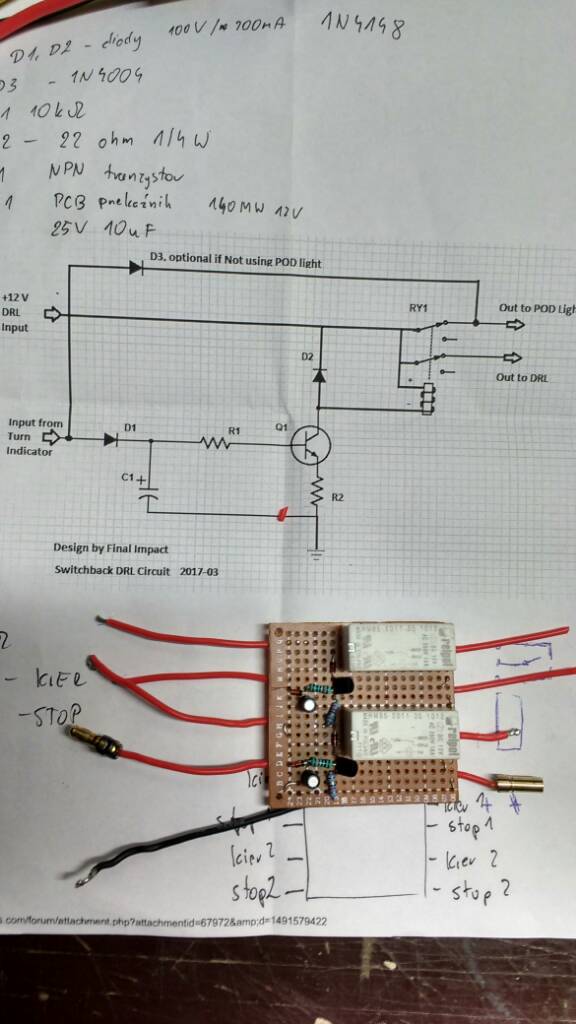

Fantastic job on this FI! At first I didn't get what D3 was for then realized your set up and the logic in it. Great job on this build and documentation!

Holidays finally here so maybe I will get to making these circuits for front indicators. Meanwhile I put a 1kiloohm resistor on rear pos lights - friends riding behind me kept complaining that they are too bright and braking light was not so much stronger. Now everything is better.

Update and big thanks - I made the circuits both for front and rear. Now front positions switch off for the time when indicators turn on. With rear I did it with stop lights. Since position lights are already less bright by powering them through a resistor the brake light goes off anytime the left or right indicator switches on. So the yellow indicator light gets the best visibility :)

[MENTION=23872]Marcin[/MENTION] how did the build and packaging go? Everything worked to plan? Hopefully there was enough info in the thread...
Yes, the info is oerfect. I simply put parts one after another onto the pcb, soldered, connected and it worked :) one relay was bad - was making the switching sound but didn't switch so I had to replace it, but the rest went smoothly. This is the picture of the rear module - 2 in 1 for rear brake lights control.

I was wondering - if you could somehow modify the circuit so instead of a big relay a small transistor is used? It would make the whole thing more compact and easier to hide somewhere under the fairings.
Oh dear, I never saw this. Sorry Marcin.
Yes, it could be done with FETs and ditch the switch. I used the relay for its off cycle too to reduce part count.
Let me know if you're still interested. Somehow I think you moved on....

Hey,
thanks for being interested. Well, my prototype version is doing just fine, I was simply thinking about making it as small as possible. So, if you ever have time, I'll appreciate the help, but don't feel under pressure - it's nothing important.
