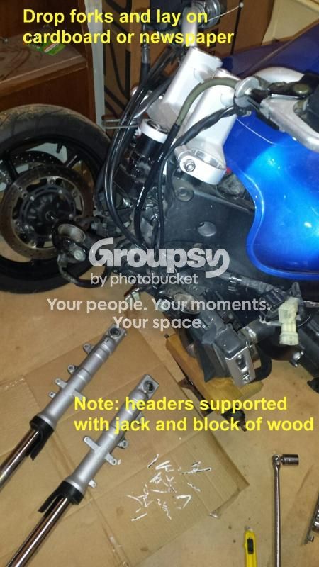

#9: Support the exhaust headers of the bike using a small jack and block of wood or a cinder block and a piece of wood the right thickness to support. REMOVE FRONT WHEEL and set aside.

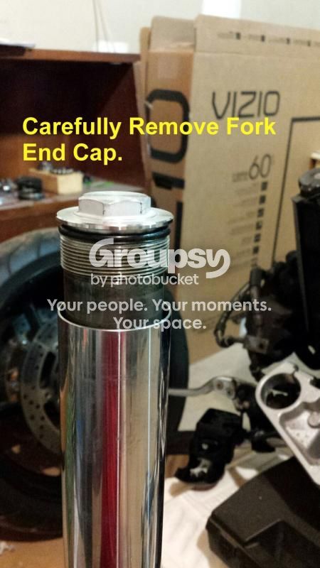

#10: Carefully loosen the fork end cap that you previously broke free while still in the clamps. If you forgot to break it free reinstall into lower clamp, break loose and then remove. Hold a rag over the fork end cap while hand loosening as there is a small amount of spring tension under the cap.

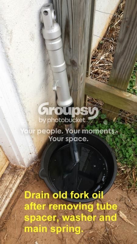

#11: Carefully Drain the fork oil into a container while holding the inner tube that will try to fall out when upended. Once most of the oil is drained, carefully remove the inner tube, washer and main spring, in that order and lay aside on something absorbent. Do not mix up parts! Keep the parts for the right fork together and labeled! Each fork is stamped "R" or "L" on the lower inners.
Pump the fork a few times slowly and don't bottom it out fully. Let it drain upside down for about 10-20 minutes.

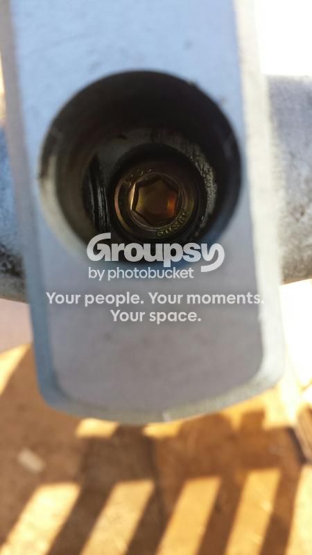

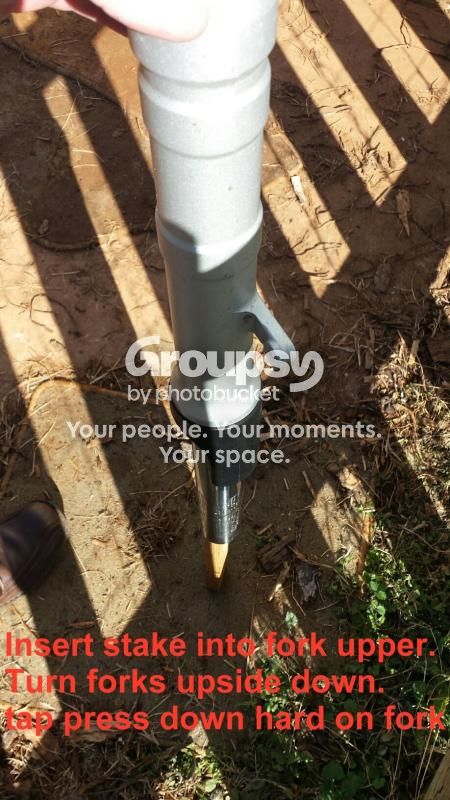

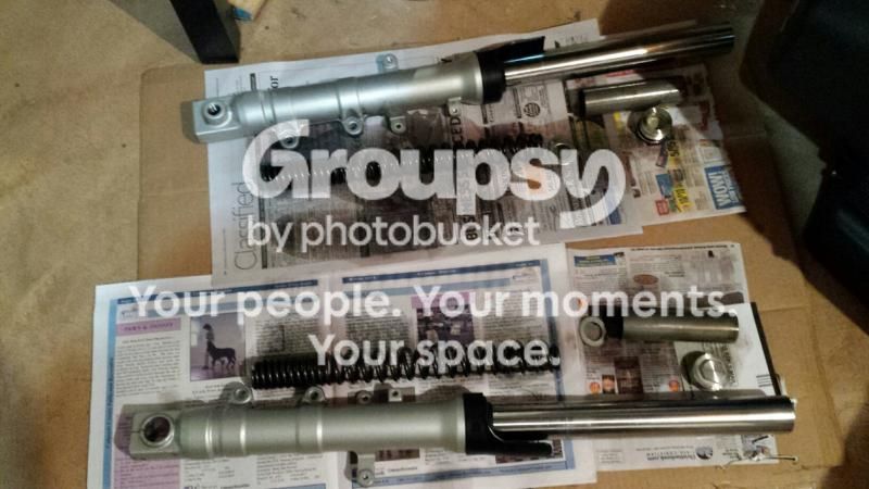

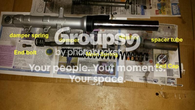

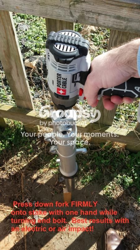

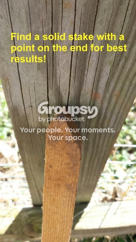

#12: Remove the Damper Assembly from the forks:
First you will want to find a solid wooden stake with a width of about 1 inch. A pointed stake like this worked great for me! You will push the stake into the fork until it contacts the damper assy. inside. Pressing the stake firmly into the damper will jam it enough to allow you to remove the end bolt that holds it inside the forks.
Here's the end bolt you are loosening.
Once you have removed the end bolts, slide the damper and short section of spring out and remove the end bolt and its copper washer. I would definitely replace this copper washer as it's what seals the fork oil from leaking out at the axle! At the very least you should coat the threads of the bolt under the washer with RTV to prevent a leak when you reinstall. The copper washer is Yamaha part# 90430-10171-00. I found the washers on Ebay for about $5 for 2.
Since splinters of wood may have gotton into the damper when you used the wooden stake to jam it, you need to clean the damper really well as any debris can cause problems later! I rinsed mine well with diesel fuel and then hit it with an compressed air to dry off. Brake cleaner would also work.

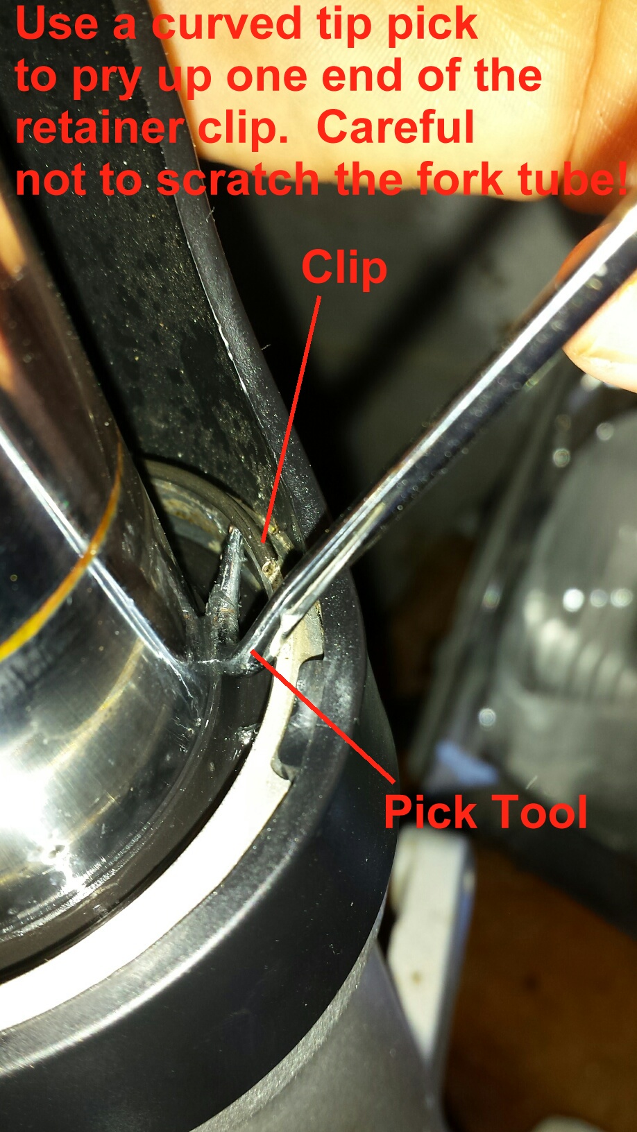

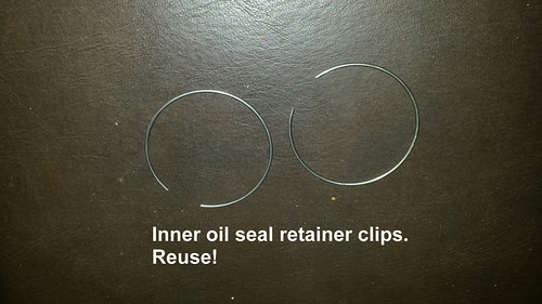

#14: Use a pick to remove the inner seal retaining clips. Don't try using a screwdriver. A proper pick will save you a lot of problems on this thing! Trust me.
[url=https://flic.kr/p/r2zmN2]
Retaining clips removed:
[url=https://flic.kr/p/qZrfmh]

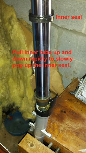

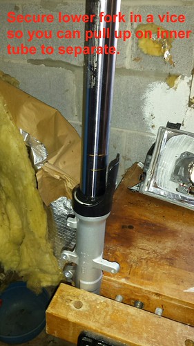

#15: Place the forks in a vice. Grab the inner tube and pull upwards, away from the lower tube. I found it easiest if you pull up till you feel the inner spacer make contact with the inner seal, then lower the tube a couple inches and pull up quickly to impact the seal. Do this repeatedly and it will slowly hammer up the inner seal.
[url=https://flic.kr/p/r2Dygf]
[url=https://flic.kr/p/r2znci]

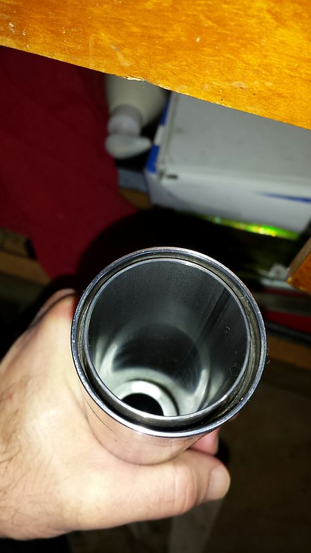

#16: Clean out the inner tube with diesel fuel or spray out with brake cleaner to get ride of any remaining crud in there.
Make sure both of the copper allow rings (brushes) on the inner tube are in good condition.

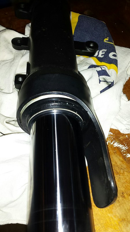

#17: TO REASEMBLE: Coat the copper brushes with fork oil. Install the bottom cap inside the hole in the end of the inner tube, turn the outer fork tube upside down and insert the inner tube.
Install The main oil seal from your kit, flat face up. Grease the inner surfaces of the seal and make sure the inner tube is wiped clean before installing and slide the seal all the way down till it makes contact with the outer fork tube grove.
Use a seal driver, pipe of the right diameter or a custom driver like I did to drive the seal in with a mallet. I used a 2" piece of sch40 PVC with about 10 slits cut lengthwise down the first 8" of one end. then used duct tape to taper the end down to a diamter that would fit over the inner tube, contact the seal and not hit the outer tube edges. Worked great! Make sure your oil seal is fully pressed in and then pop the retainer rings back in place. MAKE SURE THE RINGS ARE FULLY IN THEIR GROOVES!
Install the Dust seal in the same way. Be careful not to damage the edge of this seal with your driver!

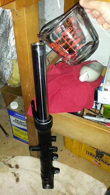

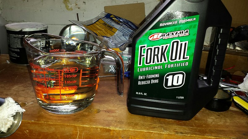

#19: Measure your fork oil. 04-06 forks take about 467mL or 0.49 US Quarts.
Support the fork assembly so it can't fall over and add the fork oil slowly.
Once the oil is added, grasp the outer tube with 1 hand and the inner tube with the other hand and slowly pump the fork all the way extended and all the way compressed, several times to get any air bubbles out of the damper. Compress the inner tube FULLY, Let the fork sit for a few minutes and then measure the depth to the oil from the top edge of the inner tube. Should be 5.28" more or less. If it's 5.25 or 5.3" don't worry about it, the key is that both forks need to be the same amount of oil so get one done and then make the second match it.

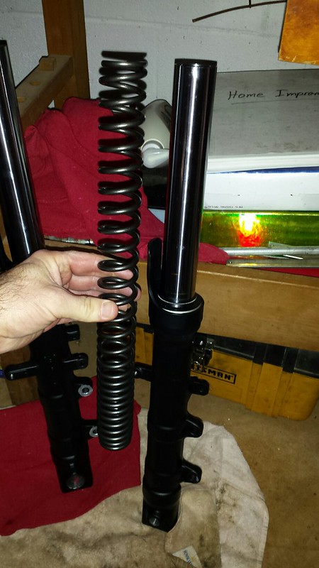

#20: Install the main spring! NOTE: THE SERVICE MANUAL SAYS TO INSTALL THE MAIN SPRING WITH THE TIGHTER COILS (CLOSER PITCH) AT THE TOP OF THE FORK! MY 2006 SPRINGS WERE INSTALLED UPSIDE DOWN FROM THE FACTORY! I PUT THEM BACK IN WITH TIGHTER COILS UP TOP AND HANDLING IS BETTER PROBABLY PARTIALLY FROM THIS AND PARTIALLY FROM THE HEAVIER OIL.
Install the washer and spacer as they were. Extend the inner tube fully!

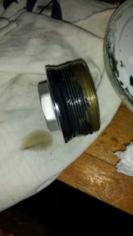

Grease up the O-Ring on the end cap and thread in by hand. You will have to compress the spring slightly to get the threads on the cap to grab. Tighten by hand until snug. You will torque the top cap once the forks are installed on the bike.

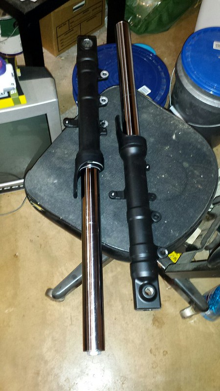

I had painted my lower fork tubes black with Plasti-DIP while I had them apart. If you wanted to paint yours the best time would be before reassembling the forks!

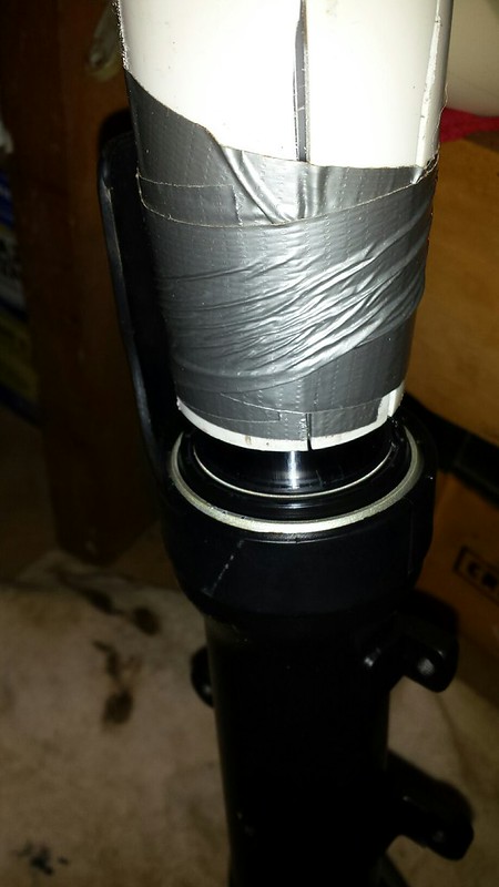

Another thing that works great for removing the front wheel is a 1/2" rod coupling nut (19mm = .748 (outer measurement of the coupling nut is 3/4")). Cheap too! I saw the idea posted on a thread on the forum. I don't have a 19mm hex, and the spark plug wrench in the tool kit doesn't fit for me for some reason. I picked up the coupler nut, and it works perfectly!
Please ADD details: GREASE THOSE SEALS before installing them and protect the inner seal from damage during install. Both actions are critical to the longevity of the seal. i.e. pack the inner lips/registers with lithium soap base grease. It will extend their life.
- Otherwise its like a knee on gym floor and then the seals leak in 9 months.
• Before installing the oil seal, cover the top of the fork leg with a plastic bag and slide the seal over the bag. It protects the oil seal during installation.
Seal driver!
From: PVC Seal Driver came from (2015-01-22)
I'm not sure if you have a proper seal driver but I made a hack tool which i used to use on MX forks. It also works on these 43mm forks.
Our 43mm forks can have the seals and bushings driven in with 2" SCH40 PVC pipe (2.0" ID). Just take section to a band saw and cut a bunch of 4-5" slices up the pipe. With lots of slits in the pipe (longer than these), you can easily resize the sawed end by placing a hose clamp or zip tie around it. Use the top washer above the bushing to drive the bushing down. Its heavy gauge. The bushing itself is so thin it can slide under the PVC. Use an old seal to drive in a new seal. Its quick, easy, adjusts to different sizes, and it works!
55965d1421968827-front-fork-oil-steering-head-bearings-tires-img_20150122_fork-seal-driver-jpg
Seal driver!
Thanks! I would have added that note about the plastic bag from the service manual but the edges of my tubes were smooth as could be and will not damage the seal as long as you grease it and put it over easily. Good point though, not everyone may have the same results I did!
Thanks for the tip about using a 2" piece of PVC like that to drive in the seals. Worked great!

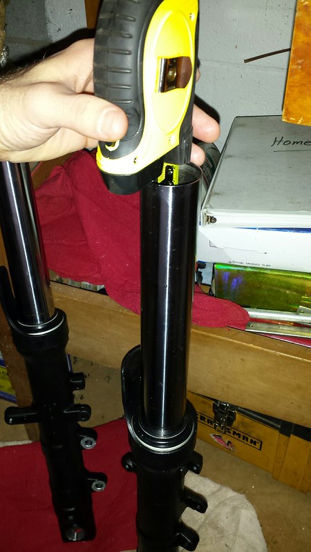

Just a side note as I just changed the fork oil in my 07..
The springs were installed from the factory (bought the bike from the original owner, my friend and I know they were't opened), the tighter spring coils were at the top...
And for measuring the fluid once assembled; I took a long screwdriver, some masking tape on the screwdriver and marked off the correct, full level with a pen on the tape. Then, simply reach down with the screwdriver until it wicks up the oil and check your mark. Easily got them within 1mm of each other.
I used the same oil you did but a 7 wt. Very happy with the oil pick, forks work noticably better.. :thumbup:

Thanks for the comment. My 2006 main springs came out of the forks with the tighter coils on the BOTTOM and I bought the bike brand new. Either my forks were assembled wrong from the factory or the 04-06 bikes had the springs in reversed.
12,535
1,182
Page 4-54 in the S1 YAMAHA shop manual shows the tighter spring end atop too.
I suspect someone wasn't paying attention (or it was a Friday) when they assembled your forks at the factory... Stranger things have come out of the factory.... ;)
Actually, if you think about it, the top, tighter winds (if at the top), DON'T MOVE nearly as much as the lower part of the spring which is directly supporting the lower fork tubes / axle / wheel.. Progressive action as the forks compress.
If there was any noticable different feel, I would think it would be slightly stiffer (as your bike currently is set up)..

The good news is I can swap the spring direction at any time without having to disassemble the forks from the bike by taking the weight off the front tire, removing the fork end caps and using a magnet wand to bring the spacer, washer and spring out.
It makes more sense to me to have the tighter coils at the bottom since the tighter coils compress faster than the stiffer coils it would give the wheel a softer initial hit when absorbing bumps and then the spring rate would become progressively stiffer as the spring compressed further. Otherwise as the fork compresses the spring is being compressed with the same force on both ends as the compression of the fork is driving the spring agains the spacer and washer wish is held on by the end cap. I really doubt I'll notice any difference if I reversed them.
12,535
1,182
Agreed, I don't think you'd feel any difference however I have to disagree re the coils. The wider space will compress (and be softer) than the tighter winds.
Thus having the tighter winds at the top really only compress (to speak of) when near the end of its travel (bottoming out)..
With the front end supported, gently raising the ft wheel (2x4's under the tire) will pop out the spacer/washer and spring. I'd just do it real slow as to NOT loose any oil to speak of. Re-measuring would necessitate the forks be absolutly verticle.. :thumbup:
I thought the same thing. Until I tested it. when I compress the tighter coiled end of the spring it compresses about twice as much as the end of the spring with the looser coils when the same force is applied on that end.
