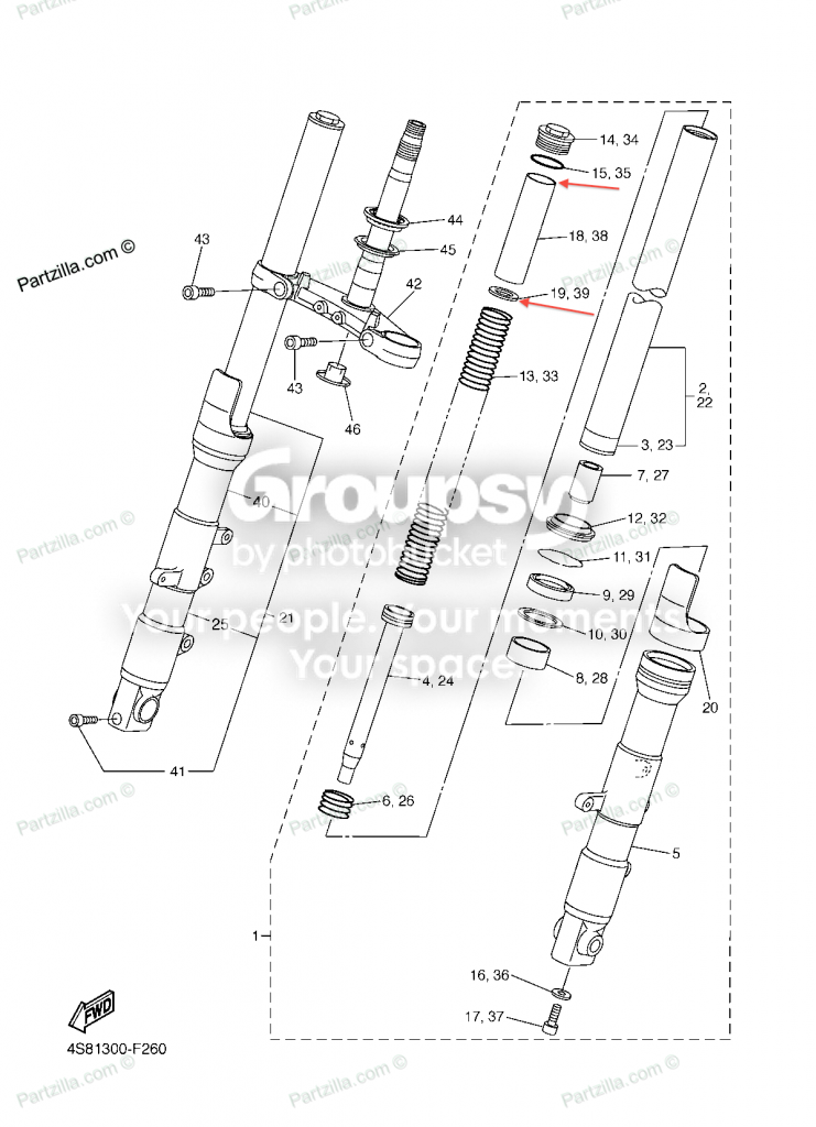

Why not just put the spacers just under the top cap, above the long tube spacer (part #18 & 38)?
Its doing the same thing and you won't have ANY CHANCE of a "foreign" object tearing up moving parts?
that's what i was going to do... not sure what the advantage of putting them both sides of the spring is, but it sounds like a lot more work!
