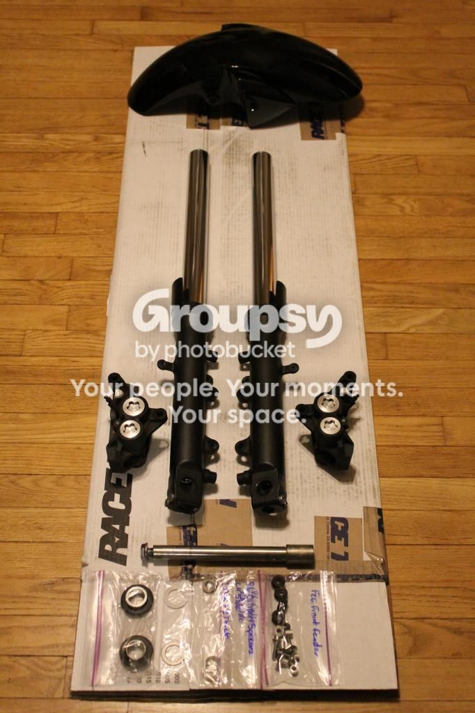

From the pic it lookes like the purchace came with proper axle shims. Do a search, there was a member on here who sold the kit. I have links in the thread Something Black. Follow them on the fork swap. Look for something likr ** Dak08 ** thats not exact. But something like that.
Also take a close up picture of the shims / spacer you do have. Calipers just need some ss washers.

From the pic it lookes like the purchace came with proper axle shims...
Unfortunately; he was #2 on the list and #1 actually bought my kit (the one in photo)!
To Griff: Nice work on finding another set so quickly! Please find the information below for the shims used in the kit that I sold. The wheel shim is based on the use of the R6S wheel spacer; not sure if those were included in the set-up that you bought.
Part Numbers Mentioned below are from McMaster.com
Caliper Spacers:
*Note: The total required shim thickness is 2.5mm. Shims of this thickness in the size required are not readily available. Total thickness is made up with two separate shims
Item 1:
Qty: 4
Inside Diameter: Ø8mm
Outside Diameter: Ø14mm
Thickness: 1.5mm
Part Number: 98089A119​
Item 2:
Qty: 4
Thickness: 1.0mm
Part Number: 90214A518​
Wheel Spacers:
Qty: 2
Inside Diameter: Ø22mm
Outside Diameter: Ø30mm
Thickness: 2.0mm
Part Number: 98089A467​
