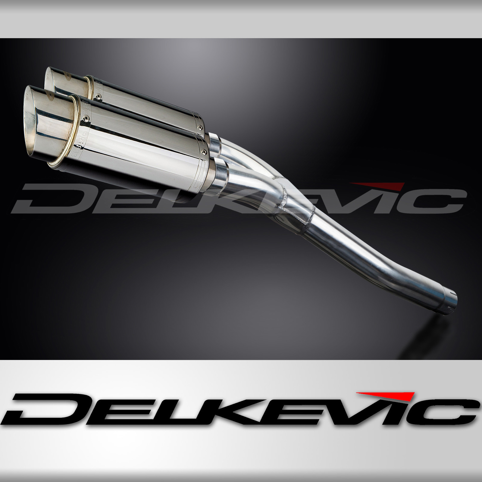

They look pretty good and that's a very cheap price. I guess you would have to roll the dice for what they sound like or maybe you could find a youtube vid. at that price really you get what you get. One thing looks weird though is the straight pipe.. doesn't look like it will fit into the cat. I think it should point down

I probably am going to see if I can find one somewhere online.. I thought that too with the pipe but some modification could fix that.. If I find a video or end up giving it a go I will for sure post on here after I get it installed.. Would be funny if it was the same maker just oem due to legal stuff.

Too good to be true? Guessing I would need a Y pipe too?

I think the cans are plenty good but the connecting pipe could take some work, I would guess very few of us can weld and bend pipe so the cost for an exhaust shop to make something up could bump up your cost a bit.

I would go for it. The Y-pipe is upside down in all the pics lol. Looks like it tapers properly and would bolt right up to the cat pipe.

Do you know if those Delkevics require repacking?

I bought my delks from a member on this forum. I have run them for about 2.5 years now daily run 10 kms to and 10 kms from work each day.
I opened one of them about 12 months ago to see how it was going and there was barely any scorching of the glass packing.
You have to remeber these cans are supposedly for track use only- they are pretty loud, but you can set up the baffles so it doesn't attract the attention of the authorities.
I wrapped the baffles with extra glass woven sheet and then filled the baffle with stainless steel exhaust packing. I did this more for my hearing than for anyone else.
I really love the sound with out any extra packing around the baffle but I used to get looks from the police on a regular basis.
I reckon the cans are good value

Maybe for a righthand drive fizzer!?? lol
If that Y pipe section is welded solid, turning it over points the mid-pipe connector in the air. Hopefully it is a slip fit.
Let us know what happens.
