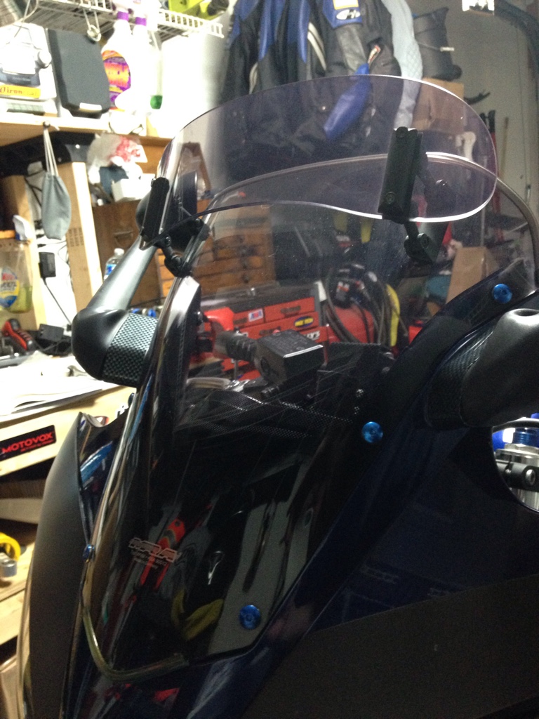

I have the MRA touring screen. Basically the stock screen with an adjustable foil.
This is Puig, not sure which tho. Its taller than the mirrors and me at 5'11" w 32" inseam seems to be OK.
Bike has FZ1 bars.
