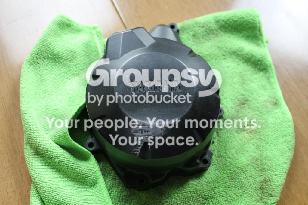

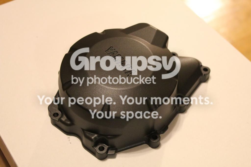

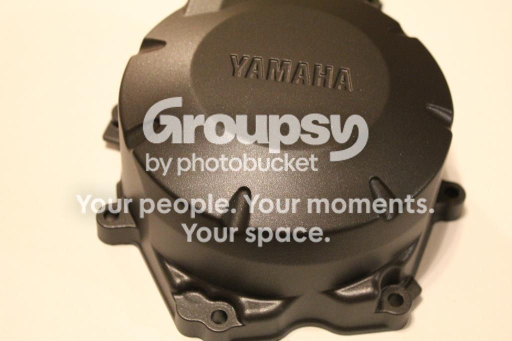

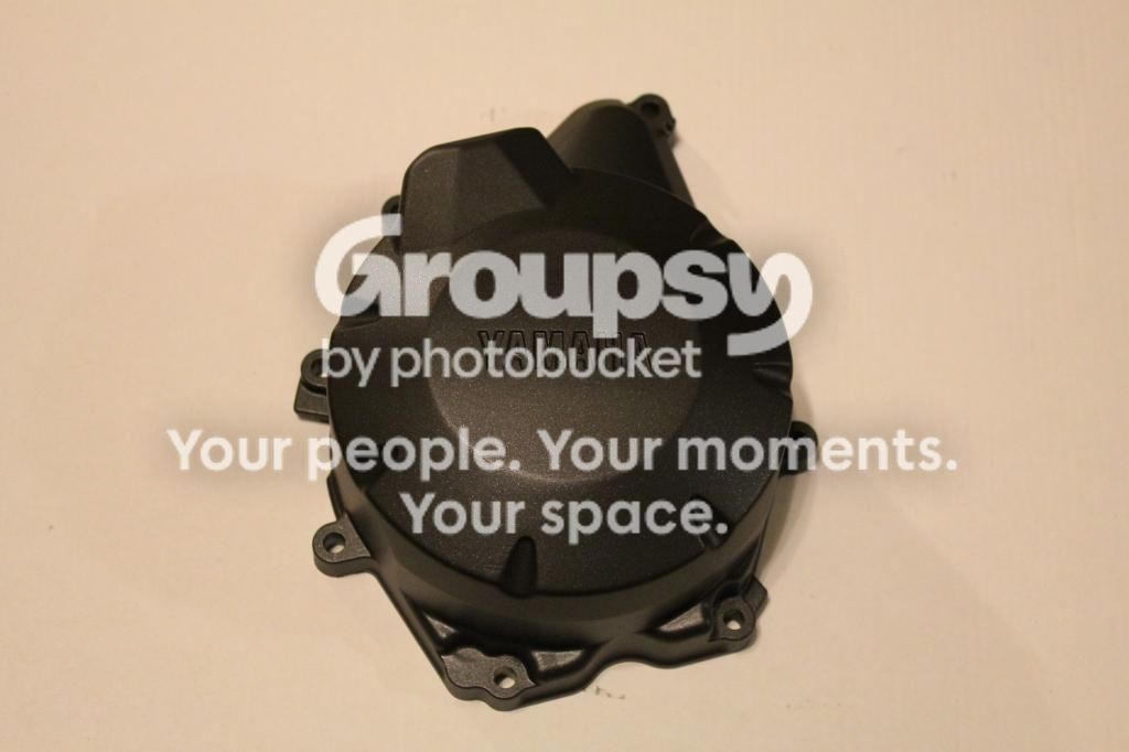

So I came across a damaged stator cover from my old 07+ when I was cleaning the garage the other day and was wondering if I could fix it. I replaced it at the time because a can of true color-match paint is nearly $50 with shipping.
Long story short; Off to Advance Auto i went. The first can I picked up was as close as I think you can get without paying the big bucks. Thought I would share: please see the photos below.
Paint: VHT Engine Metallic
Color: SP405, Black Pearl
Link: VHT Engine Metallic

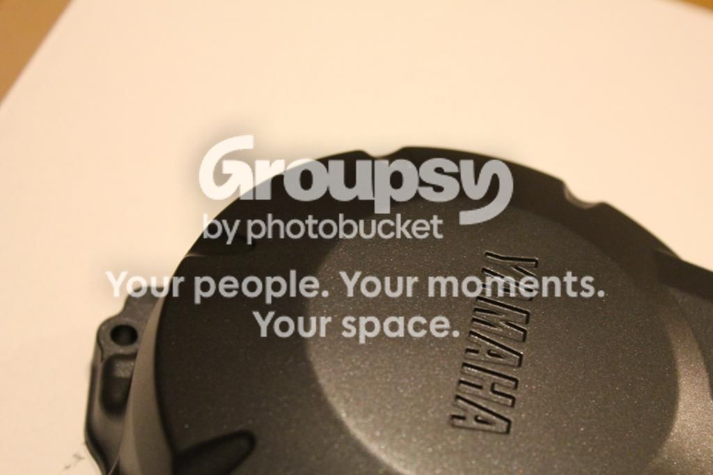

I don't think I would call it "Perfect" in person; In some light you can see that the tone and depth of color are a bit different. I first painted a small patch to cover the scratched area and the difference was noticeable up close. I hid this by extending the coverage area and putting the paint "seam" on the edge.
I think it is a great inexpensive fix that most people would not notice. I would recommend trying it in an inconspicuous area first so you can see what it looks like in person.
Buy VHT Paint Engine Metallic, Black Pearl, 11 oz, Aerosol SP405 at Advance Auto Parts
$9 cost, compared to a new cover from Ron Ayers @ $70'ish, or the local stealership @ $120'ish

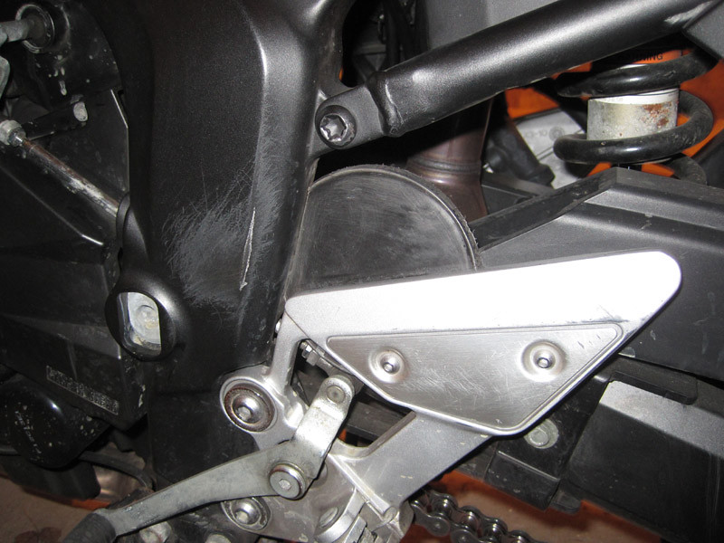

Bumping this because over the weekend I noticed that the zipper tab of my new Aerostich suit has been scuffing the frame of my bike for the past couple weeks :(
How do you think this paint would work on this area, as far as blending into the existing paint? Or should I spend the $40 for a can of colorrite paint?

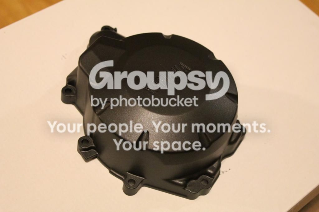

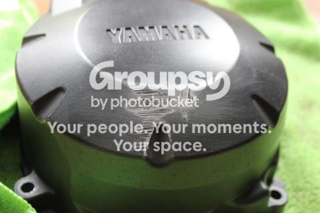

Had another few scratches on the stator cover on the part out bike. This time I baked the part to decrease the cure time and likely the increase the durability as compared to the 7-Day air cure (Can recommends 200°F for 1-Hour)
Before: (Some sanding done already)
Cooking ;)
After:
Not 100% perfect but 100% better than it was before. Also, The paint is rock solid after the heat cure; very impressed so far.

Skooter - please see the pic in my post #5. How well do you think this paint would blend with the existing paint on the frame?
My apologies for missing this the first time.
That is a tough call. I know that when I masked the first stator cover, the difference was noticeable. Not so much the color as the "depth" and tone of the paint.
That being said, it was a "hard" tape line with no attempts made to blend to the existing paint. The swingarm on my new project bike has a few blemishes that need to be touched up. Perhaps I will try a few different techniques for blending to see how well it would come out.
Maybe something over the weekend.
^^ Off hand, unless baked on, I don't see it holding up. My rear sets looked good after a year with minimal wear but I had 4 layers of clear coat on them and it went through even though I baked it on. It was VHT High temp Ceramic Clear. Also, that was direct boot contact. Rear sets are now powder coated.
In the Motor cross realm, zip tie a pad on there to reduce wear. Its not gonna be pretty tho! :(
I'm just wondering about how well the paint would blend with the existing paint. I plan to put a neoprene or some kind of fabric flap over the zipper tab on my suit, so I'm not worried about any additional wear once I re-paint it.

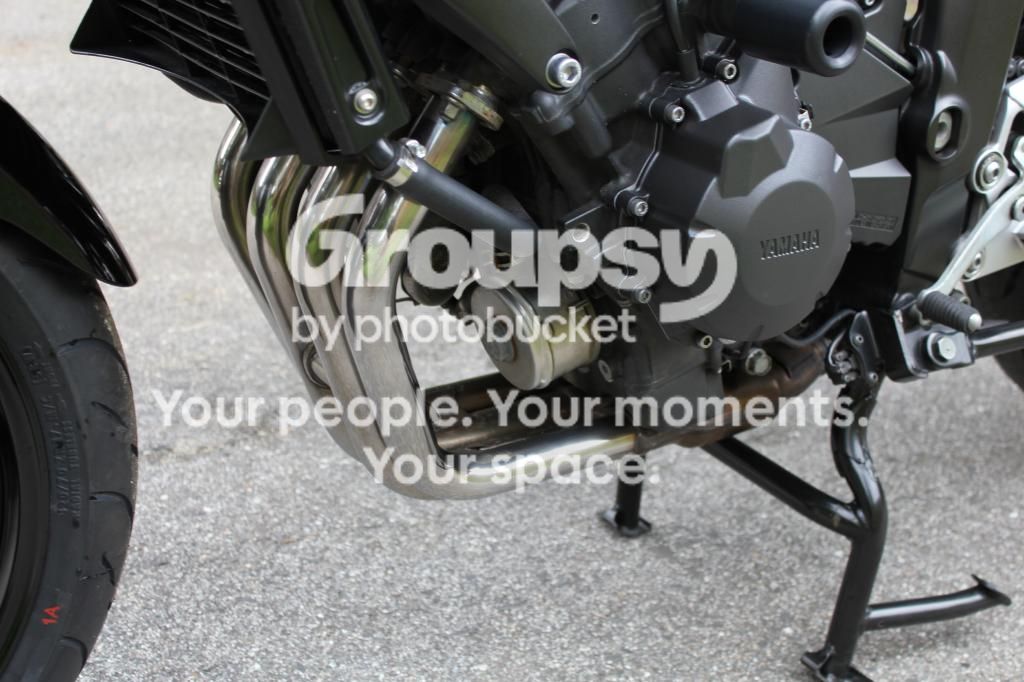

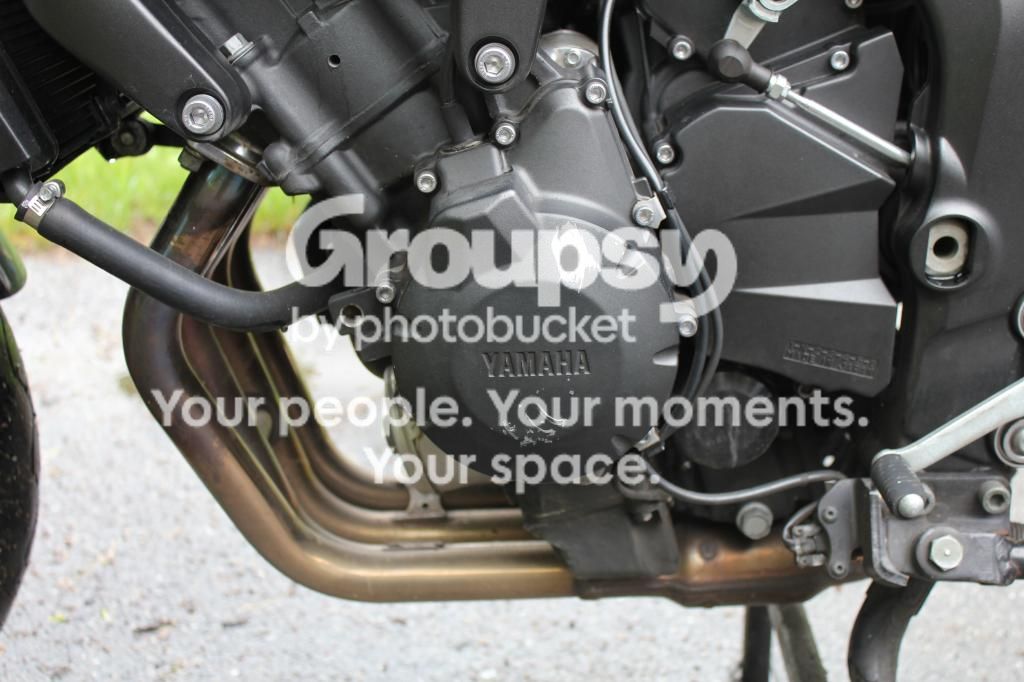

A quick Update:
Wanted to show a before and after while installed on the bike. Again, not a absolute perfect match but it is close enough that you will not notice in most cases.
Before:
After:

That may not look "perfect" in person, but on this here computer it does look perfect.
