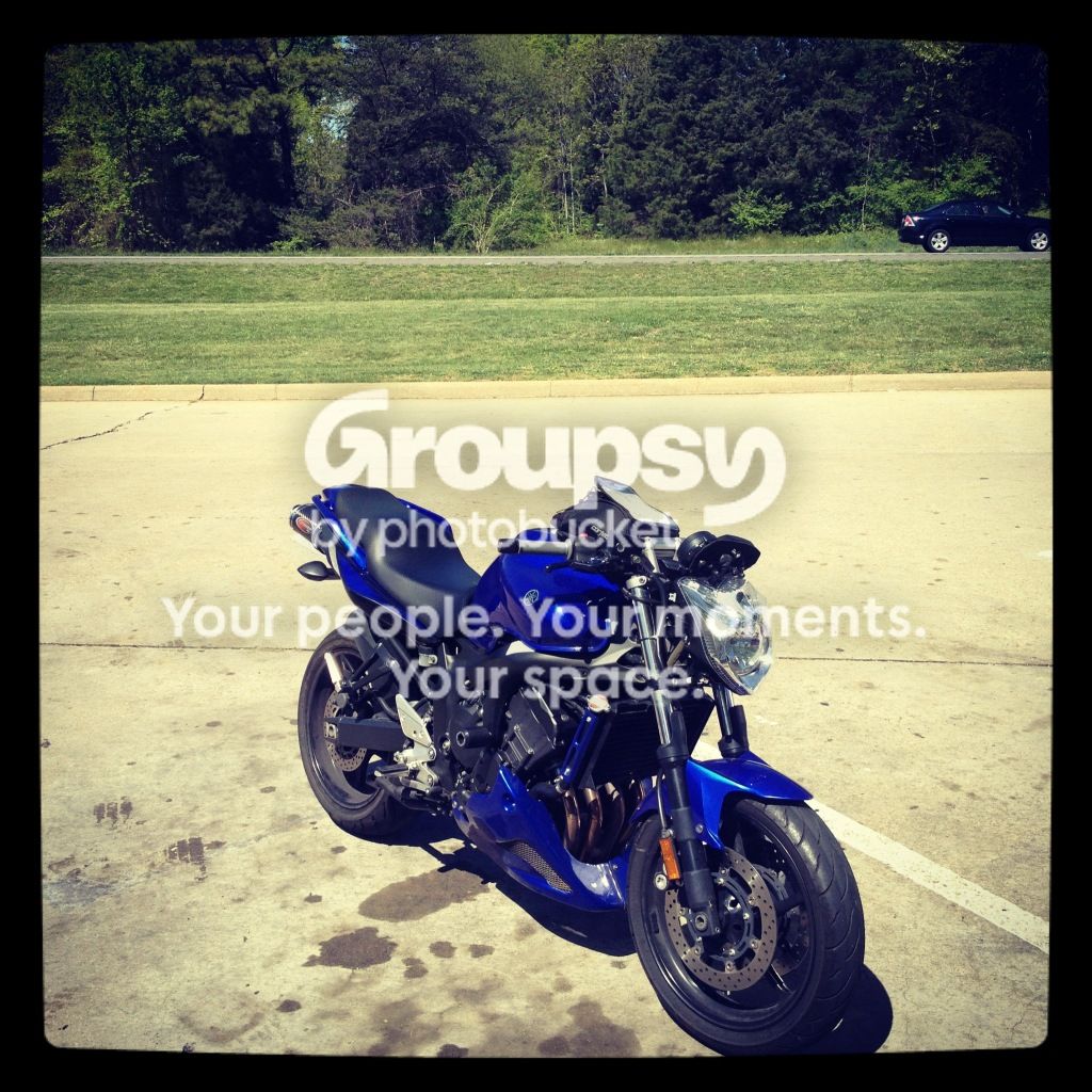

I'm the only person I know of who did it to an FZ6.
The day I sold it:
I loved it. Working on a custom streetfighter FZ1 now!
GGSteelman
Oct 13, 2011
43
Harrisonburg, VA
That bellypan looks huge.
What brand is it?
Not sure, came with the bike. I like it as naked as possible, so I just had it on there for the guy who bought it.
Even more sick: I'm using my stock FZ6 front end parts to make a custom front end for my FZ1. It will be mounted to the R1 forks. Custom is fun!

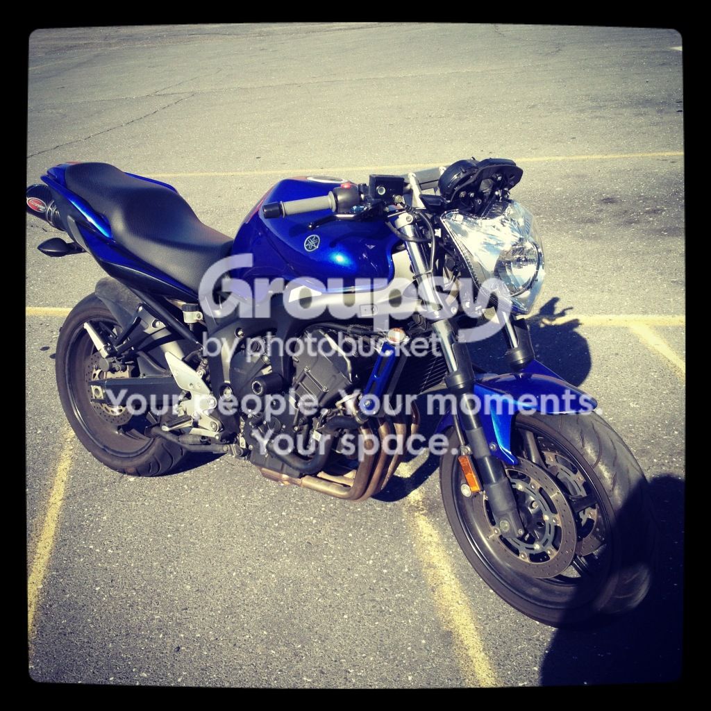

DISCLAIMER this is a rough fit picture it is not done DISCLAIMER
I am working on this swap currently with all the plastic bits to go with it. Looking at doing a full "How I did it" thread when I am done with it.
