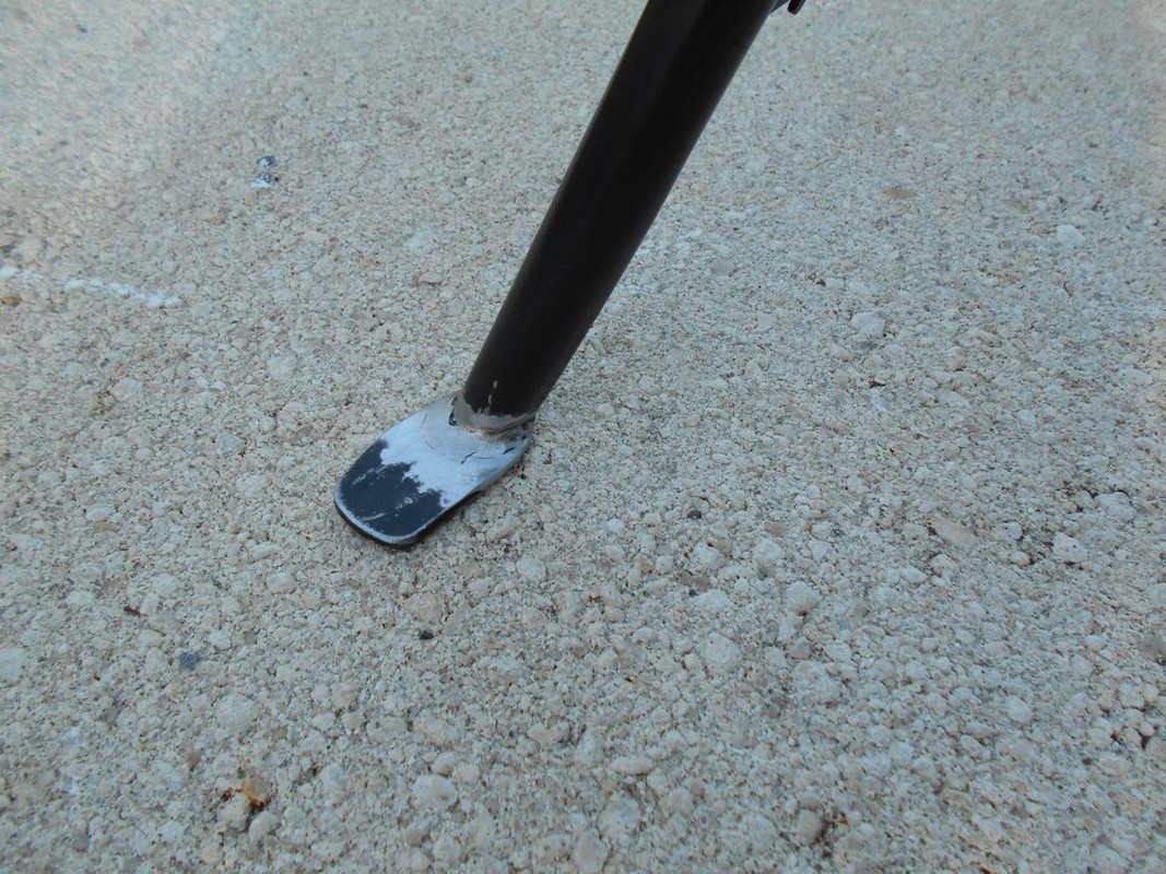

Your kick stand is also likely shortened(or after market) and you'll need another stock kick stand. Hopefully you still have the center stand and they didn't hack that up.

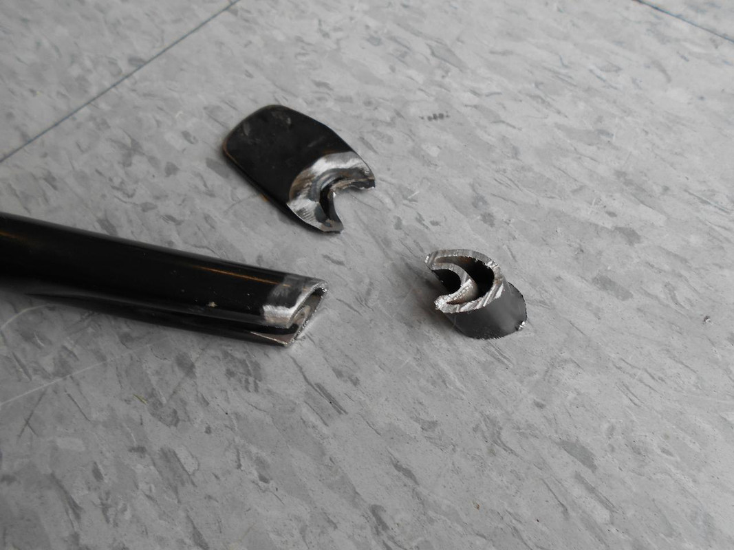

Don't forget to get a STOCK kickstand.
One I shortened for a member that lowered the bike:
