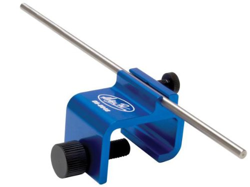

I use a Motion Pro alignment tool.
It works well for me when I eye down the chain using the rod.

How close are your Suzuki marks compared to using the above tool?
Very close if not spot on. If I get a chance this week I'll look at the reference marks. My bike tracks very nicely and guidance on and off the pulley look great. :)
