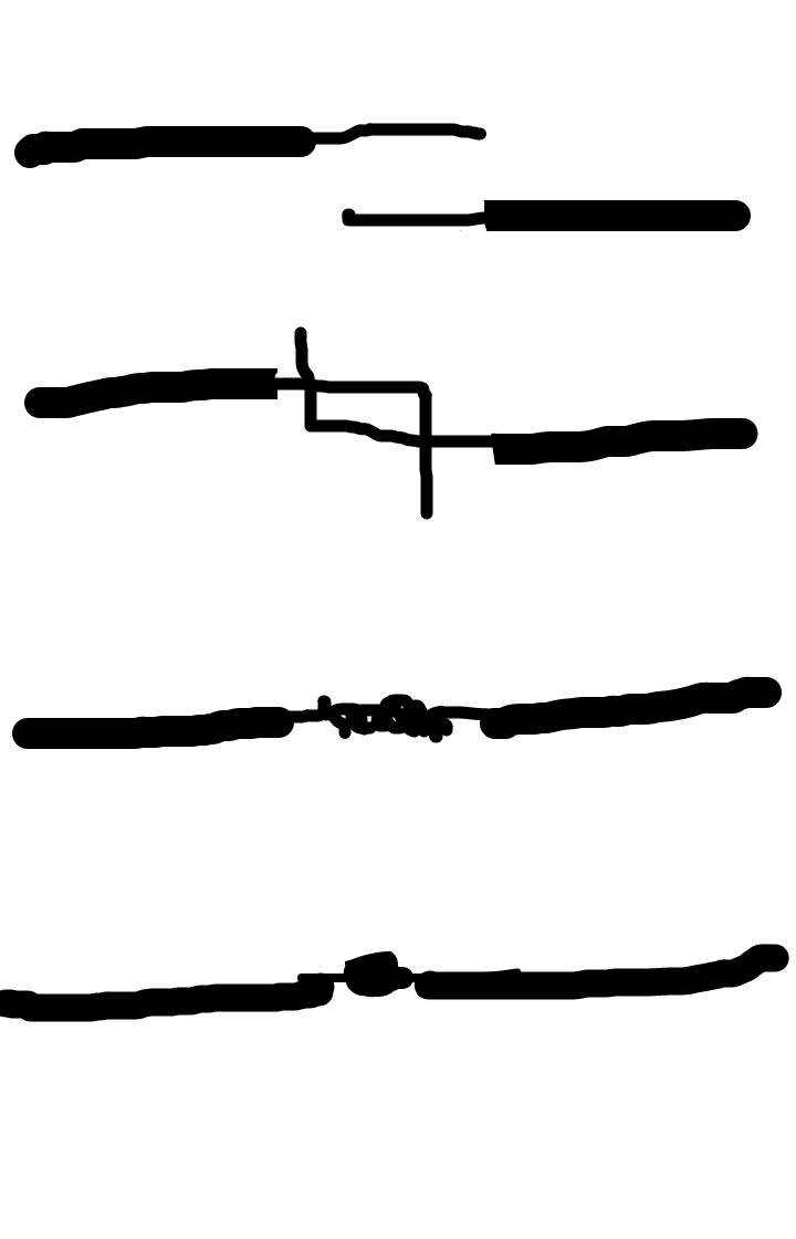

Where all that factory tape has been removed, wires spliced incorrectly, etc., I would re-do that mess. It shouldn't really be that difficult since they're all color coded. So step one I would disconnect battery, then splice back everything that's been boogered with. If something is cut short then same gauge, same color, making a good splice. I like Western Union splice like I drew...from top about 1" insulation removed, two wires wrapped together as shown (interlocked), then solder it, then heat shrink tubing over it. One or two heat shrink pieces about 2" long of course over wires before making the connection, away from soldering heat until cool then over joint use heat gun.
I would want everything back as factory...then troubleshoot/check everything with a test light or voltmeter after reconnecting battery. When all is well wrap with electrical tape as factory had it.
