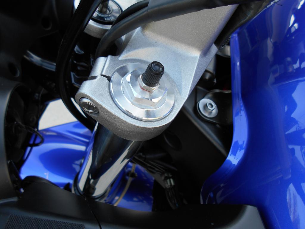

Now I did add the air Schrader valves to the forks so some weight is back onto the rear.
Most of the nose sag is gone (adjusted to my liking), not too soft, not too hard, but juuuussst right!
Been there about 3 years, added a little air twice. 16 PSI is about the magic # for each leg (for me).
Seems to be keeping the fork seals tight too. 26,000 miles, seals/ tubes, nice and dry (did do a fork oil change
