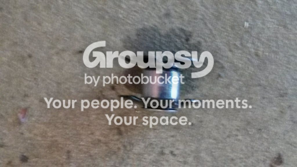

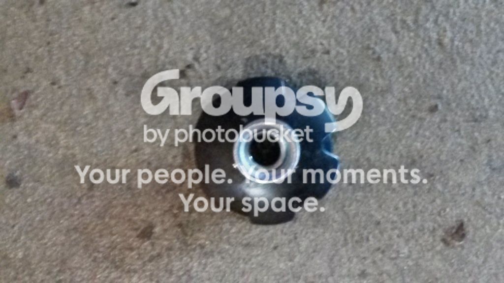

Here are mine.

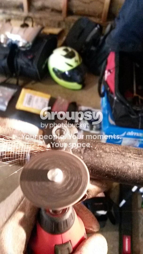

The I.D. of the tubular frame of the motorcycle is slightly smaller than 1", and a little grinding of the star nut is required. Take your time grinding, and compare it with the frame often so you don't grind too much away. It should still be larger than the I.D. of the tube, but only ever so slightly. The 'fangles' that are inserted first should be closer tolerance than the ones to the rear of the nut to allow for easier initial insertion.

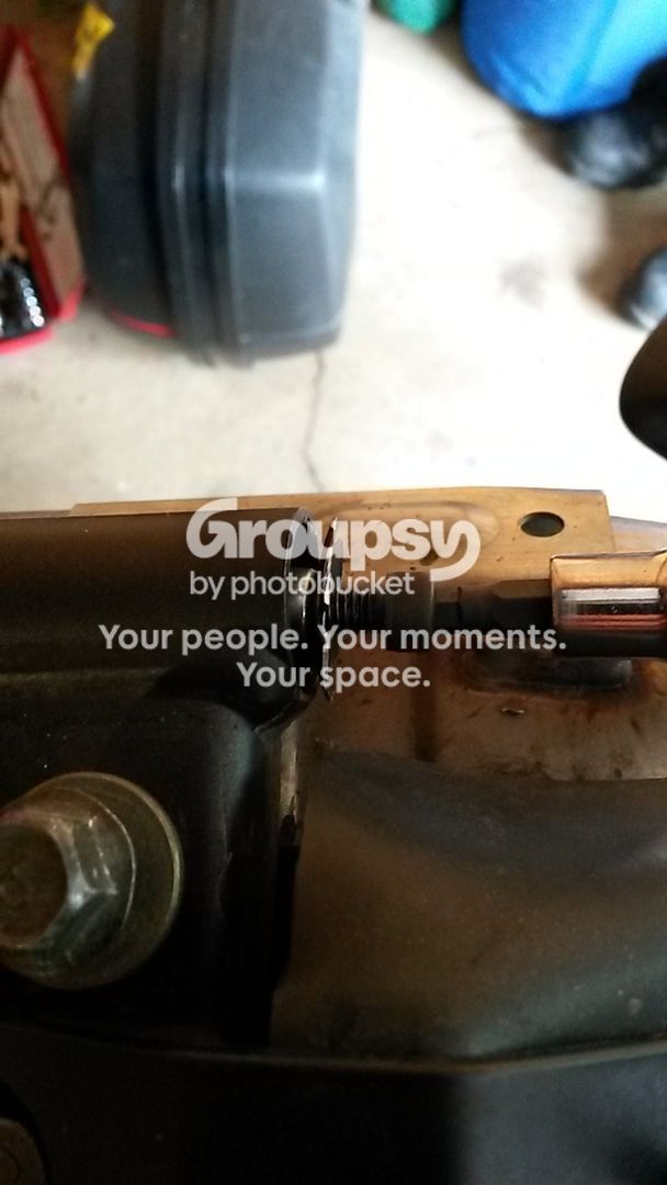

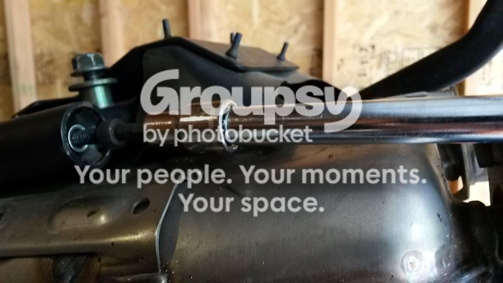

Once the 'fangles' are ground down, they need to be hammered into the frame. Do this by threading in a bolt and tapping the bolt. I put in a hex bit with an extension up to the bolt to get a better swing of the hammer. This also gives you leverage to keep the nut going in straight. Take your time and make sure the star nut goes in as straight as possible!

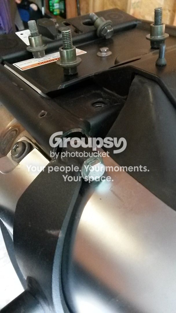

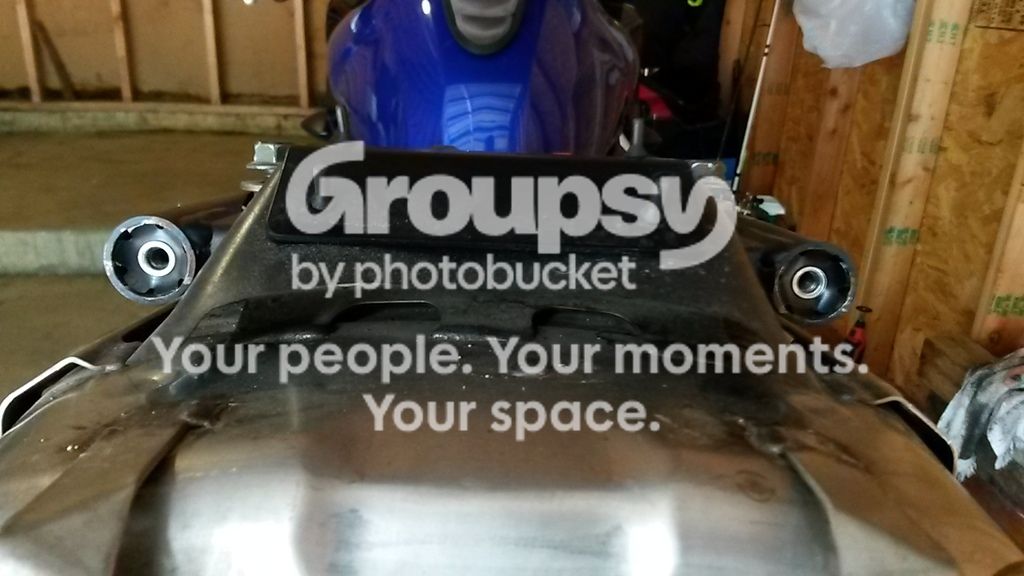

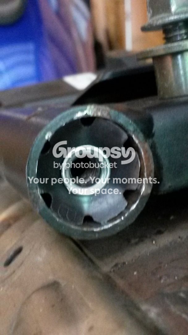

Both installed
Close-up
You'll need two 6mm bolts about 2" long (unless you hammer the nuts really far into the frame you'll need longer bolts), and two washers.
Finally assemble the top rack per instructions.
