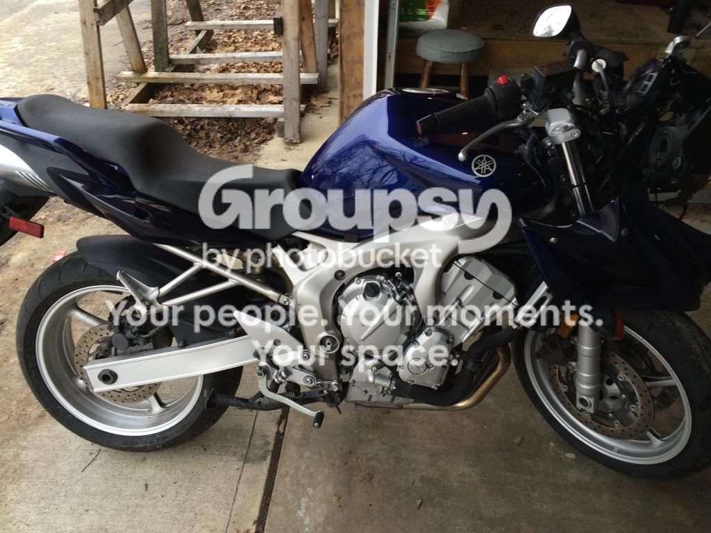

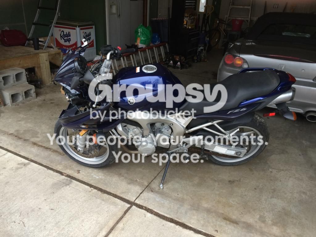

Just purchased this 2004 FZ6 for super cheap to rebuild as a commuter. It was totaled due to front/side damage and a frame issue but it will be fun to work on and rebuild as a project. I will be doing a streetfighter conversion on it and I'm really looking forward to working on this project and doing a build thread. Here are a couple pics of the damage. Lots of work ahead of me, but thats half the fun!! :thumbup:
