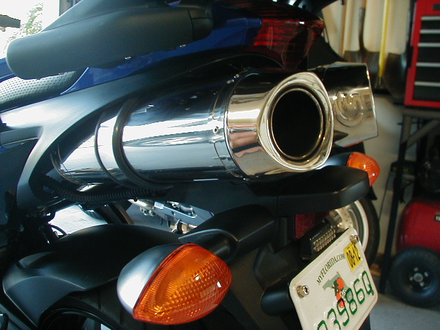

If that's anything like my Two Bros, that is L O U D. I have to run it with the inserts otherwise I'm too embarrassed to ride through my town.
With the cat's, no, it's not bad keeping it under 5k (which I usually do). After that, yea, it's loud and sounds really good IMO..
Local, around town streets, 4K is 50 MPH, which is about the highest in town. Un-less I'm feeling frisky or a vette pulls along side, it's not an issue at all.
Actually. I had to special order the DB killers. They didn't make it to the end of the driveway before being yanked (as it sounded like the stock muffler.) Someone got a good deal on em..
I have the DB killer installed in the right side only of the 2 bro as its pretty loud. Bike is catless with an S1 header. The good news is dear no longer plot intercept trajectory and actually turn back! So public nuisance or life saving. I'm going with life saving....
