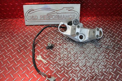

I guess some guys got in and busted the ignition/fork lock full off the fork. What do I need to fix this? Do I need new forks?

Thanks for the response, gents. There're some cheapish ones on ebay. Anyone know how complicated it is to get that off? I'm praying they didn't short anything when trying to "hotwire" it. Need to find a seat and side covers too.

The eBay/Amazon lock cylinders typically work well. If you want to use just one key for the bike, be sure to order the ignition set and fuel cap kit. Also, be sure that the harness on the ignition set is long enough. I forget the required lenth...but simply measure your existing harness to make sure that the replacement is in the right zone. A seat you might find on ebay (or the for sale thread here). Looking at that seat, I'm thinking you can straighten it out with a heat gun (off the bike).

I'm really sorry to see and hear of the attempted theft. They must have been realy keen to take it doing so much damage to the triple clamp. Hope you can source parts quickly and insurance covers the costs. I second the idea of a heat gun on the seat base, just take your time, that plastic will have a critical temperature when it goes to mush

New used triple clamp on. Some used flairings on. I turn the key and get no power?
