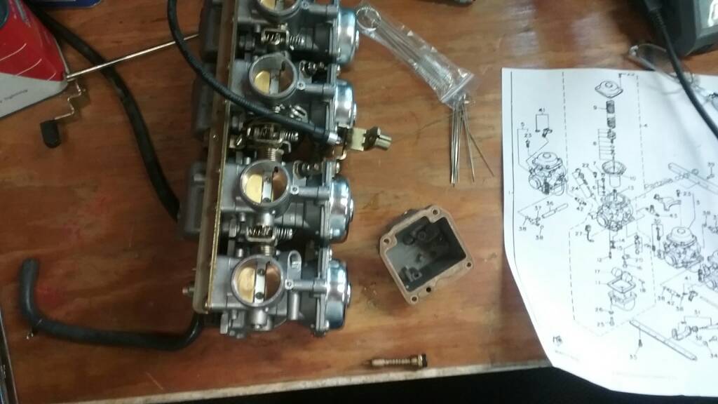

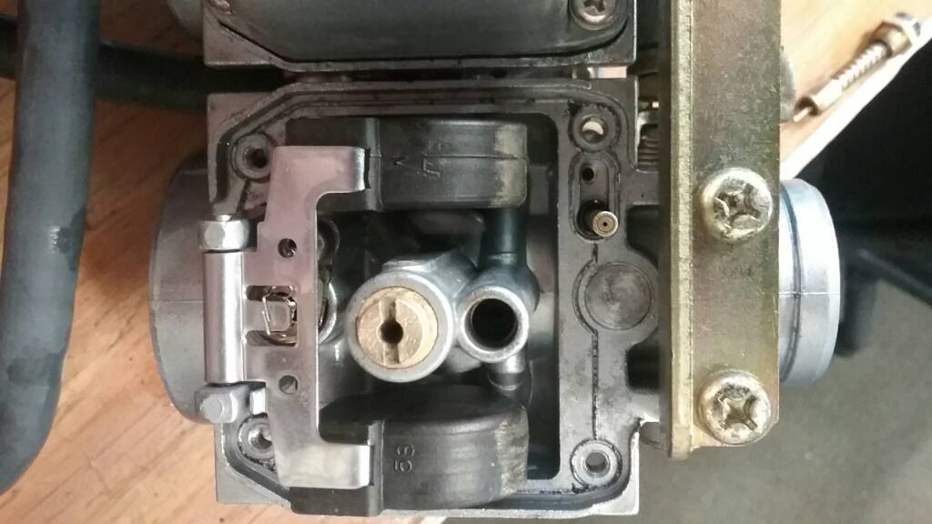

I posted a month or so ago about my 1986 FZ600, 1800 miles, bought new. I rode it 1 year the parked in garage after draining fuel tank. Carbs were a mess so I rebuilt them, soaked, clean, lube, blew passages 150psi air. Everything works smoothly except choke. I have to spray some starting fluid or carb cleaner into air box to get it running. Only about 10 miles since rebuild, I tried various additives...no help.
I have them back off the bike but can't figure out how choke passages work. All looks clean but apparently stopped up somewhere.
I only put 90 octane 100% gas in it, but there's jelly stuff in float bowl. Is that the additives I added? Main thing is how do I fix choke problem?

I've seen Stabil goo up and cause issues (IMO, junk). "Gas Shok" (very popular in the marine world and I run in ALL my gas machines) works really good, up to TWO YEARS, IME.
Looking at your pics, did you pull out ALL the jets, clean and visually look to make sure you can SEE LIGHT THRU ALL THE JETS?
(The one pic looks a bit corroded).
In any event, to fix your choke issue, I'm sure you found the "choke plungers" (that pull out when you activate the choke lever).
When that plunger is opened, it opens an orifice in the carb body allowing extra fuel to be sucked into the engine (choke).
Remove each plunger and peek in the hole. Carb cleaner (at least) will be needed. When sprayed into the body orifice, and when it's CLEAN, it'll shoot out in the throttle bore itself (providing choke).
Right now, you pull the plunger open, but the orifices are clogged...
If it's really bad and you can't get it clean, a sonic cleaner may be necessary to clean it fully.

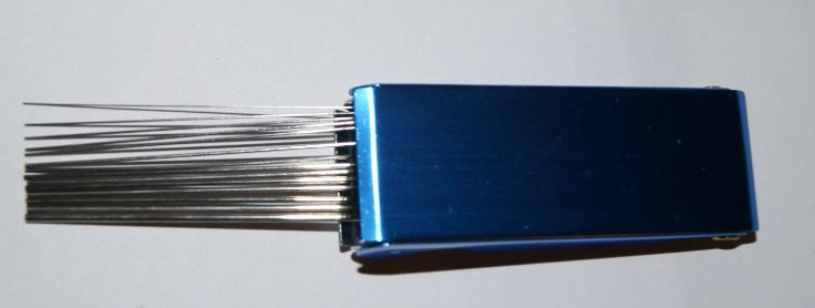

Yepper. Just double check with brake cleaner that when blowing thru the choke orifice, the cleaner DOES COME OUT elsewhere..
If it doesn't, it's still clogged. They do make carb cleaner that you soak the carb in (disassembled) however, I was able to get that Kawi carb choke orifice (and it was a b...h!) clean with what your doing....
Don't think I mentioned but I also used a jet cleaning tool.. Their available super cheap, very fine(different sizes) but of course, they ONLY reach the first hole till it turns....
This is exactly what I use: https://www.ebay.com/itm/Carb-Jet-C...ash=item211e71c626:g:RLYAAOSw0vBUi4bi&vxp=mtr
Paid for itself MANY times over...
