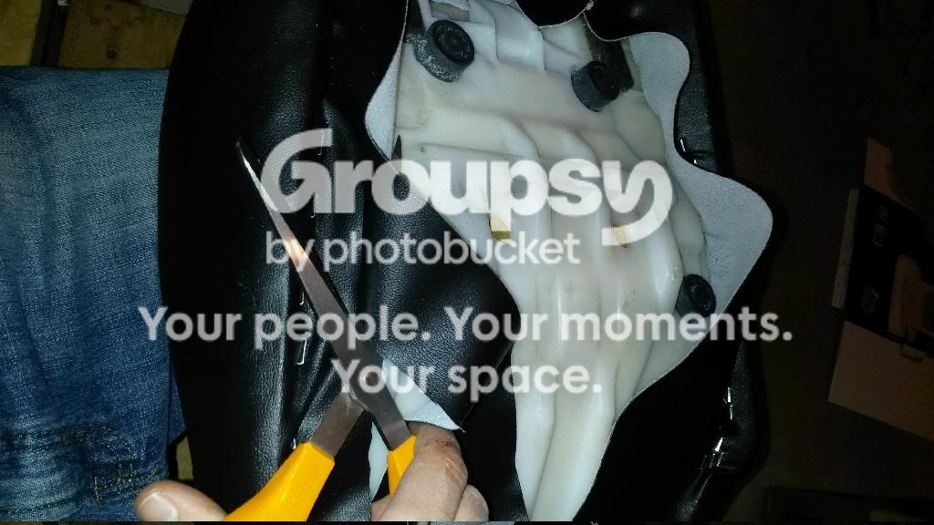

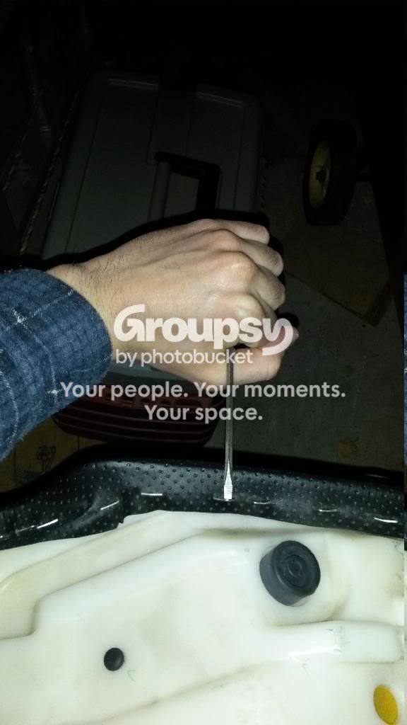

Remove staples. Pry up with screw driver and finish pulling them out with the needle nose.
Once staples are out remove the cover

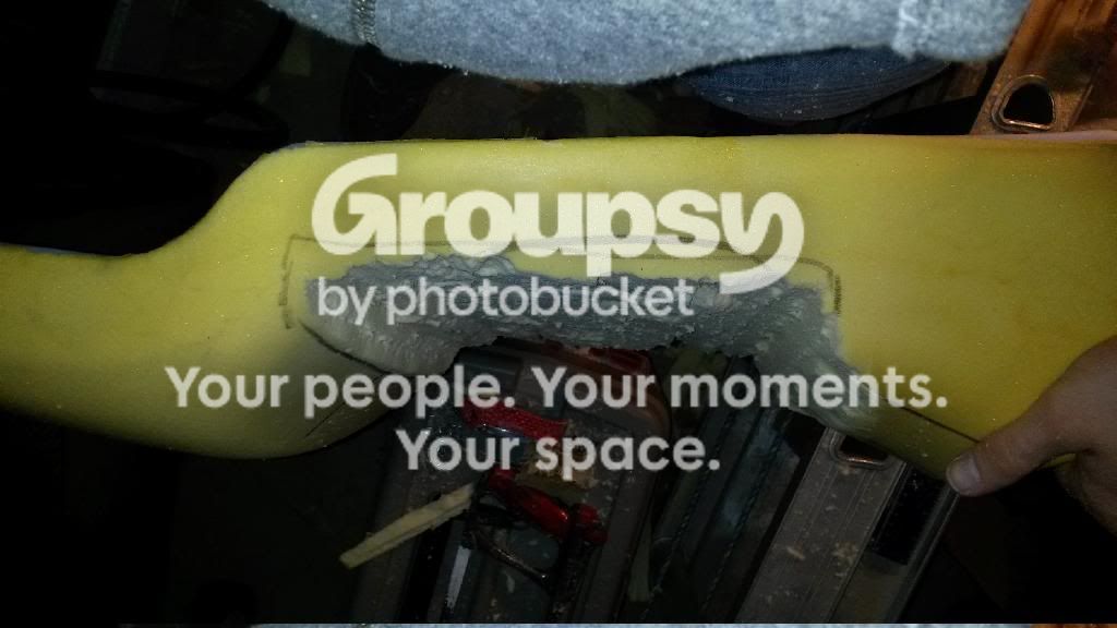

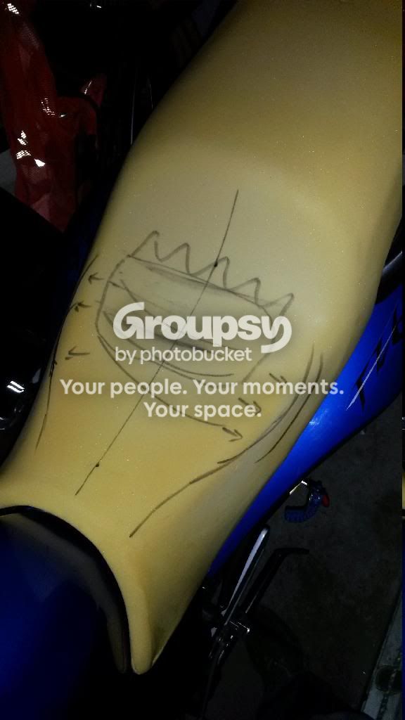

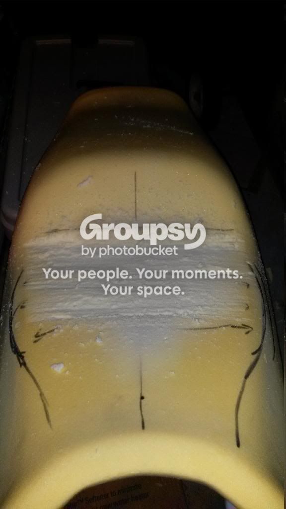

Use a sharpie to draw what youre trying to accomplish. These squigles made sense to me at the time

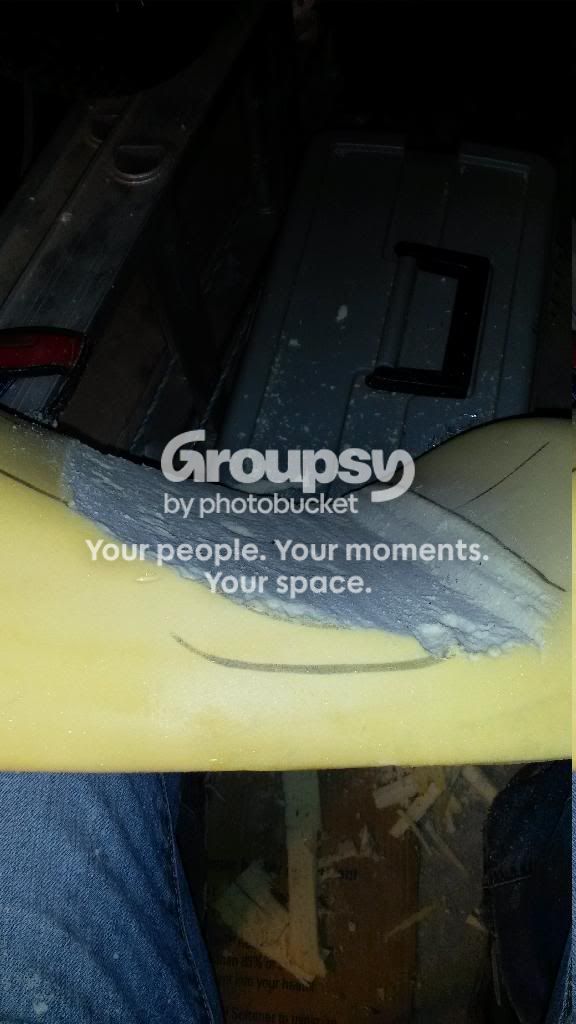

Grab youre blade and cut!
I was nervous to cut too much at first, but after reaching the point of no return i began to cut deeper.

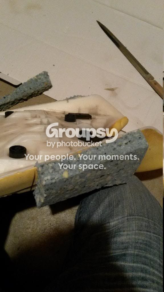

You can see that nasty curve of the stock seat is no more! I was aiming to dish out the spot my butt is on to add support. This pic is upside down..deal with it. This is about as deep as i cut before gluing on the rebond.

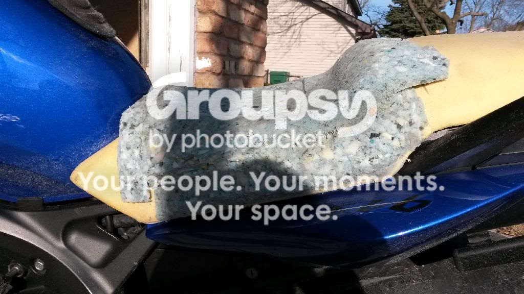

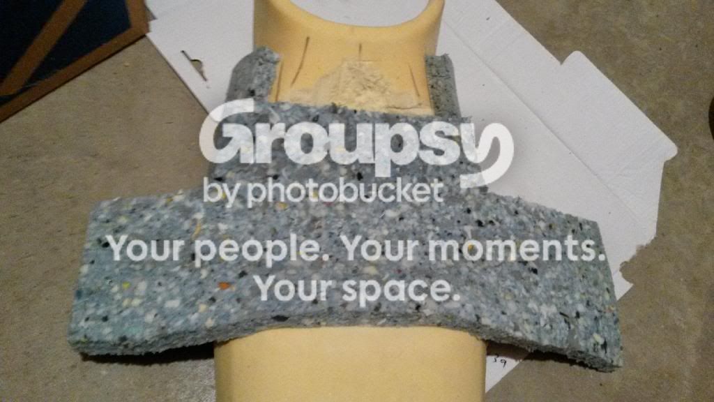

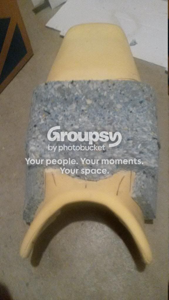

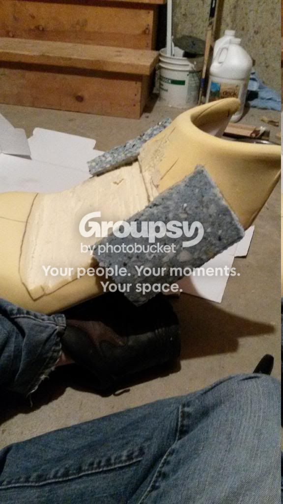

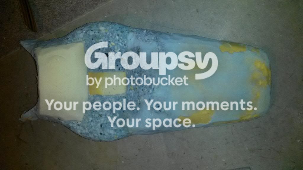

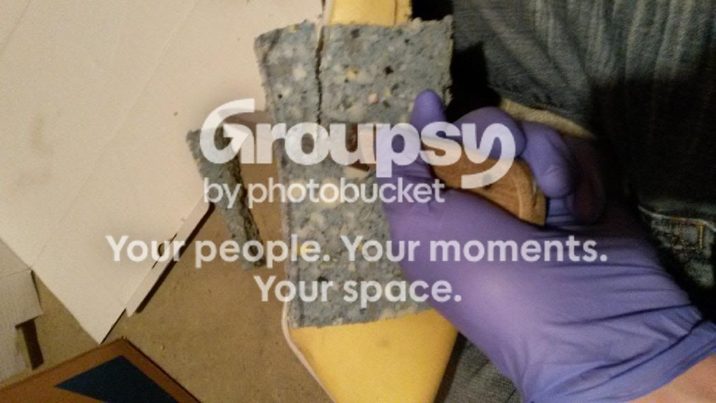

Take your rebond and glue. Here i was just trying to add support and widen the spot under my thighs. Glue and trim excess foam. To glue, spray both surfaces, let them get tacky (wait a minute or two), and stick them together.
Add more foam to cover the area you want and cut it to form. Its really trial and error. Just add foam and shape. If you need to add more later its no big deal.

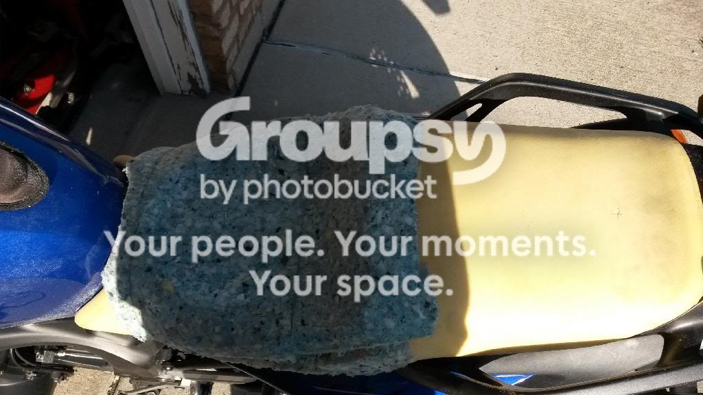

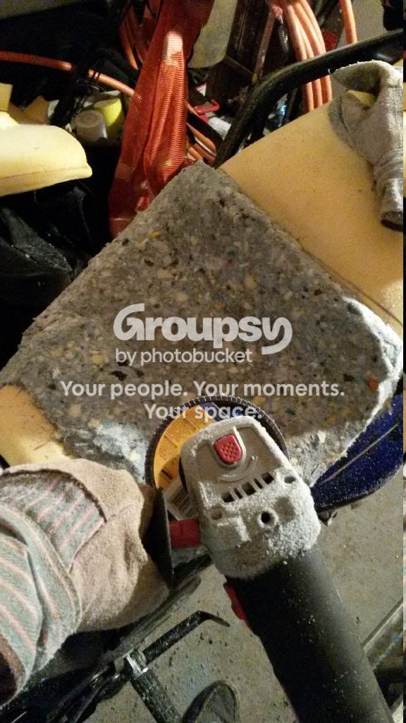

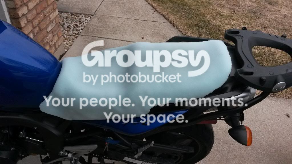

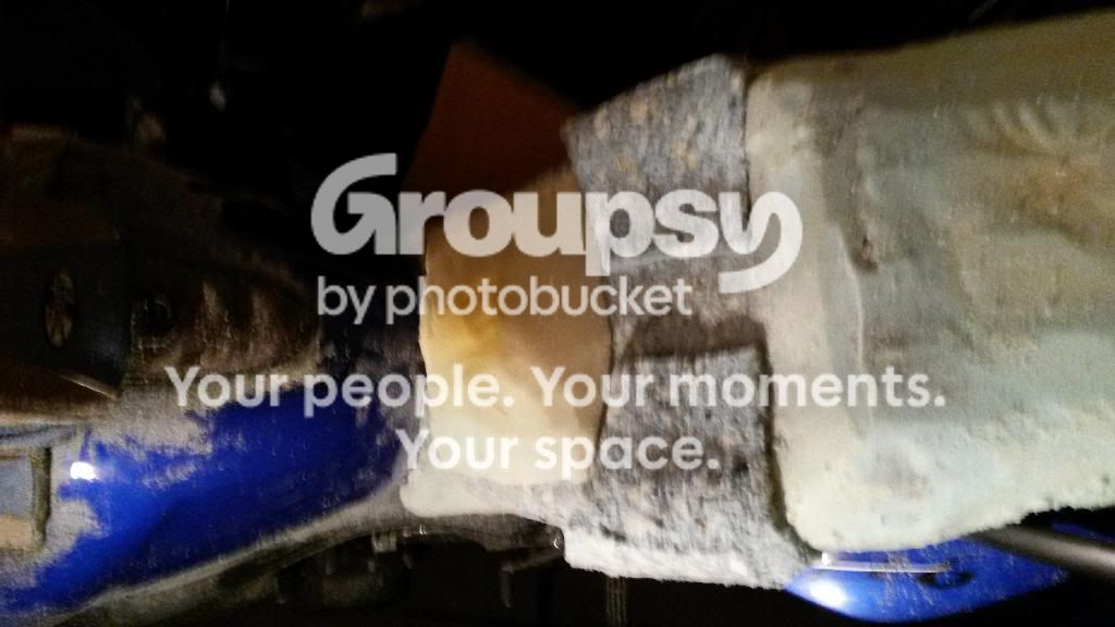

Once my foam was glued and trimmed i began shaping it with the angle grinder. It was easier for me to shape the seat while it was on the bike; this let me look at the big picute. If you do this just be careful not to slip and grind any of the motorcycle-it will scratch it bad.
Finally reached the shape i wanted (so i thought)

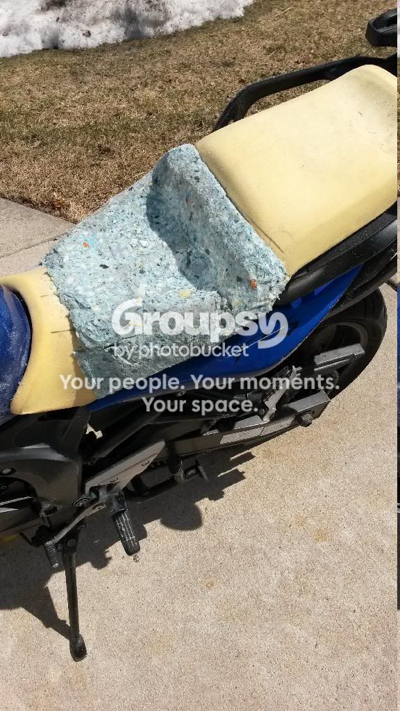

After riding it i noticed the dished out bucket shape i was aiming for was too far back. i realized i ride fairly close to the gas tank and needed more support up front. It was also lower than what i was aiming for.
Remember when i said you can always add foam later to fine tune your shape? I did that here 3 times to add another layer. You can see the lines in the foam where another piece was added. Made nothing more difficult, just took more time. No biggie
Reshape, ride, reshape, ride, reshape, ride. Like i said its trial and error. Take your time so you find a shape, height, and riding position you like.
This is the final shape i decided on.

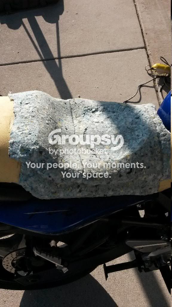

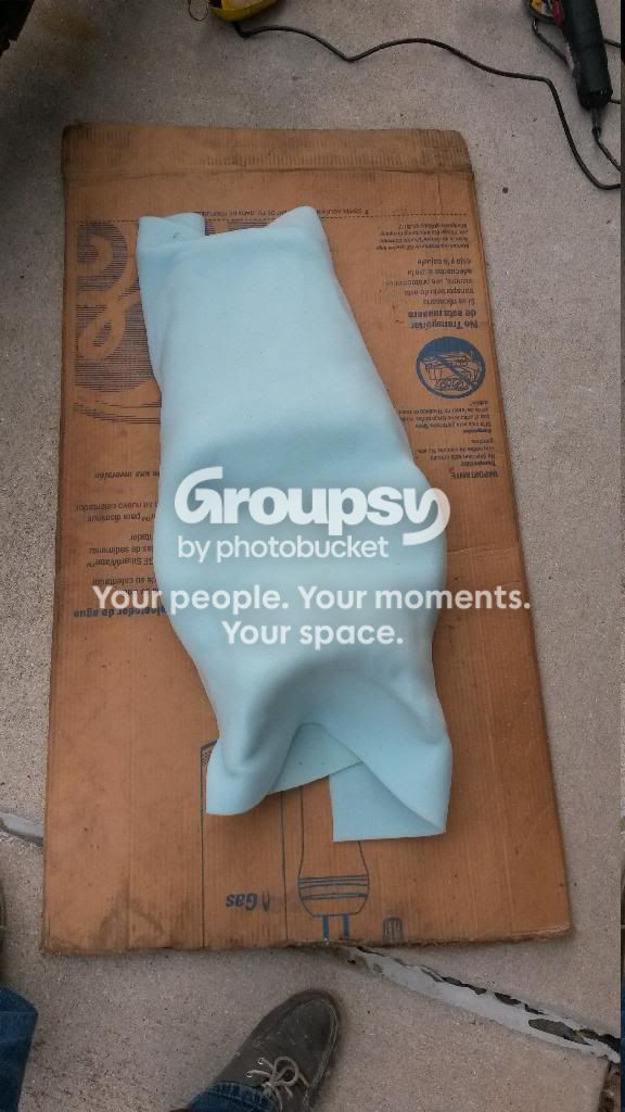

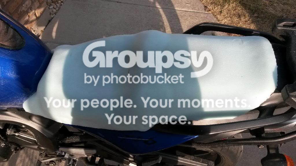

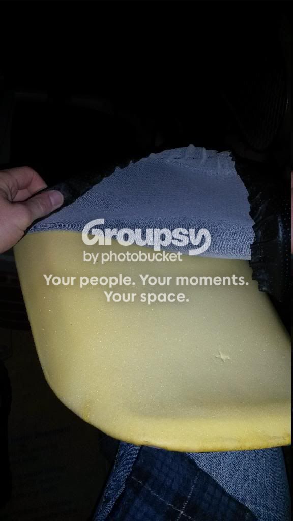

Once you find the shape you like take your 1/4" foam and cover the whole seat with it. What this does is smooth out the seat and hides any imperfections in the transition of the foams so it doesnt appear lumpy and bumpy when covered. It also adds some cushion.
Some bumps and imperfections still show through the 1/4" so i am going to add another layer once i get more spray adhesive. I used 2 cans up and didnt have enough left to put on this layer. It will also add more cushion than just 1 layer. I tried it and liked it.
All i have left to do is put the 2nd layer of 1/4" foam on and order the vinyl and cover it.

OK. After reshaping I have finally reached an end result which I am happy with. I ended up peeling off/shaving the 1/4" blue foam and adding more rebond foam to widen the seat more. I also added some very plush memory foam from an old mattress pad at the nose and under my tail bone. I then took my vinyl and stapled it on!
Blue foam gone, rebond & memory foam added for more width. Width=support :thumbup:
All smoothed out, ready for blue foam to hide any imperfections when covered.
Trim blue foam to fit shape of seat pan once glued.

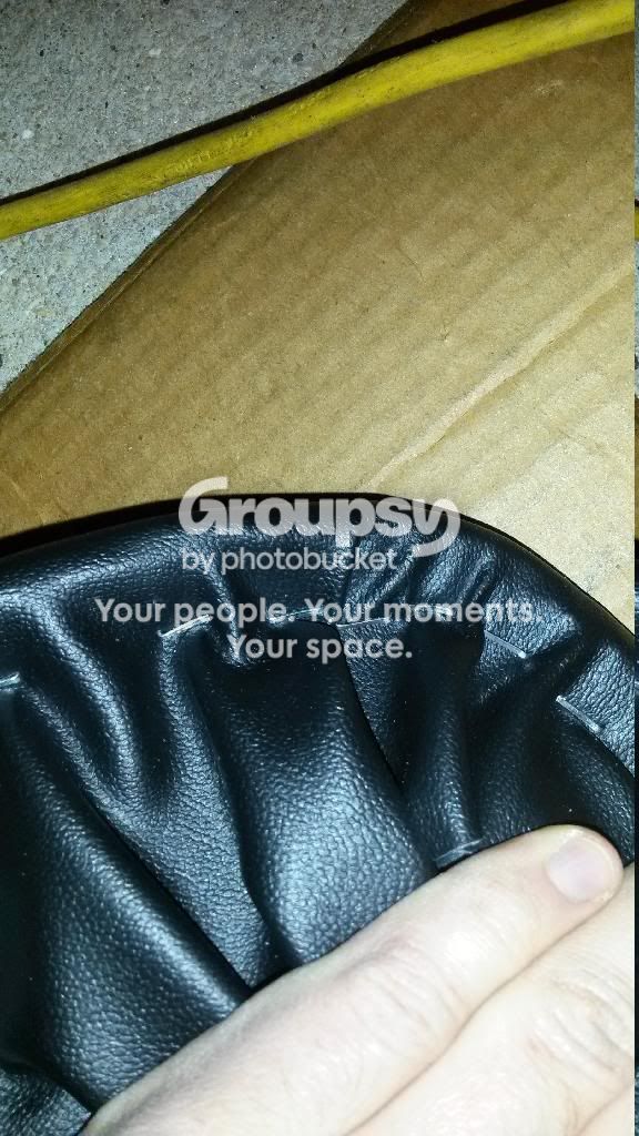

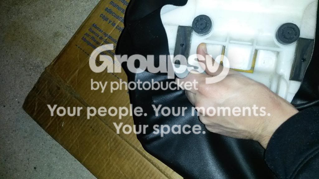

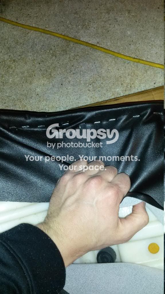

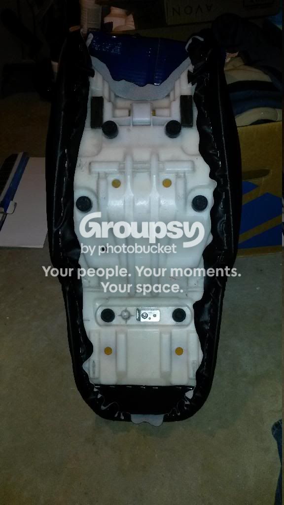

Now to cover. I used a manual staple gun. It takes a bit more patience this way since not every staple gets seated securely, but with patience the cover is now holding strong.
I covered it using the pattern on sign it or cycle seat.com. start at front and rear-staple taught. Then in a zig zag pattern staple the cover down to ensure even tension.
The sharp curves of our seat make this difficult so don't be afraid to remove staples and re-do a section to get any folds or excess vinyl out. I did this quite a bit. Also helps to use a heatgun or blow dryer or put the vinyl in the dryer for a few minutes. This makes the vinyl MUCH more stretchy and makes it easier to deal with those problem corners.
Pull tight & staple!
Curved spots will have wrinkles and folds on the BOTTOM of the seat pan, but will not show up from above as shown in these 2 pictures.

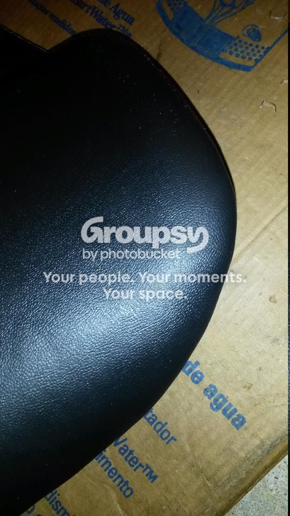

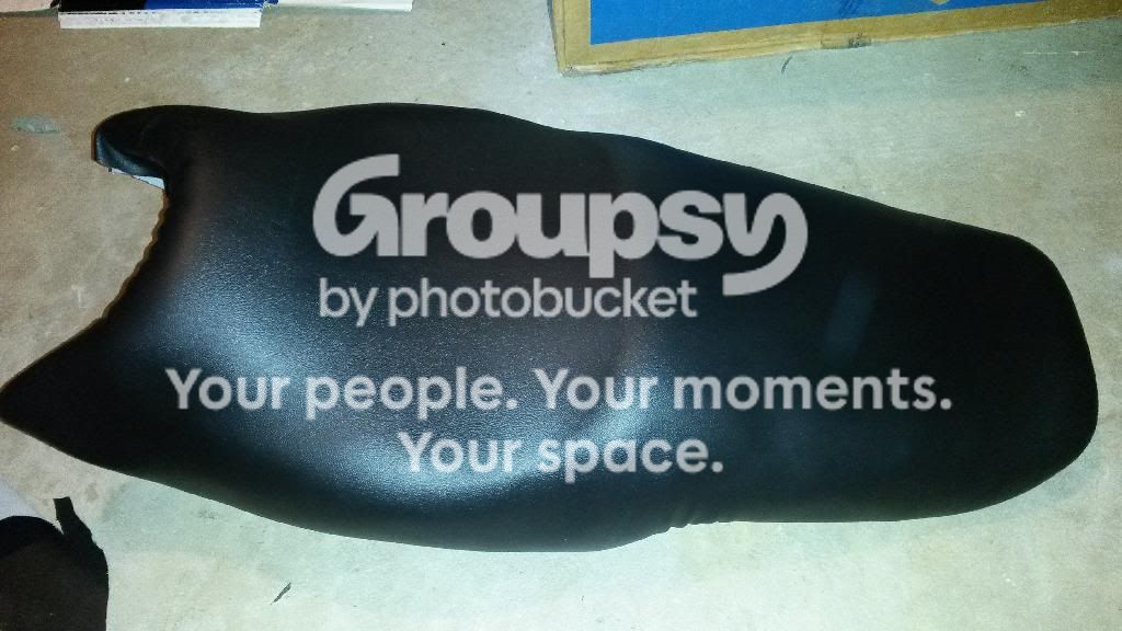

Work your way around the seat, remove staples if needed to perfect a certain area.
Once completely covered, you will need to trim excess vinyul from the underside so the seat fits on the motorcycle.

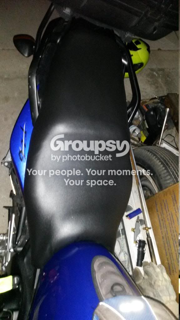

And the finished product. As you can see, there is a slight air bubble from the concave section I made. This can be minimized by pulling it tight from the side near that section. It is there, but it still looks good. The vinyl is stretchy enough that you don't notice it when you sit on the bubbled spot. Others online have glued this spot down with the spray adhesive;something I may try later on, but for now it really doesn't bother me, and it still looks fine.
This project is really one of trial and error. You will not get the perfect seat your first try. Be patient. You can really get it to custom fit YOUR body if you are patient and test ride it enough!
