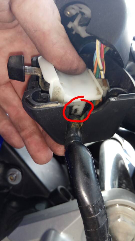

Hello,
Has anybody any experience with disassembling the indicator switch?
- I need to clean the mechanism but can't get it out, the only thing I see is the little tab (marked in the pic) but when I pry it it seems like something else is holding it in place but can't for the life of me figure out what.
Any help is greatly appreciated [emoji106]
I haven't had it apart, but it appears to have a zip tie at the wire right BEFORE it goes into the housing.
I'd snip that (may be a tab it's zip tied to too).
Any AND all small screws visible, make sure their all removed.
That white little tab you have circled, generally, you have to push the center (cut out/tab) to release it.
I would try to get the load off it, push the large part down initially, push the tab in, and see if it releases..
I gather you believe there's a bad connection inside the switch, or it's sticking?

Thanks for the reply [emoji106]
- yeah, it's sticking, tried both with contact spray (cleans&dries out leaving almost no residue) and silicone lube spray and it works fine for a while but then starts sticking again.
Gonna give it another try tomorrow, if I succeed I'll post photos to help the next guy down the line.

I had to clean mine a month or two ago as well, right turn signal wouldn't work due to gunk in there. I wish I could remember what was holding it on, but I ran into the same issue as well, held me up for a bit trying to figure it out. I cant say for 100% certainty, but I think there was a screw hidden holding it on.

*To be read in the worst infomercial voice you can imagine;
Is your indicator indicating it has problems? Ladies, do you keep breaking fingernails on that stiff indicator lever? - This guide is for YOU!
1. There are 2 screws on the bottom of the left hand switch assembly, take them out and move the switch assembly away from the handlebar (they are different in length so make a note of it).
2. Remove the first screw holding the indicator switch mechanism, and unclip the ziptie holding the cables going in the switch assembly.
3. The second screw is "hiding", rotate the upper half of the switch assembly 'till you spot it then unscrew.
4. Now you will be able to move the indicator switch mechanism, you need to do so in order to get to the screw that's holding the horn switch. Once you unscrew that one the horn switch can come out, it's a bit fiddly so be patient and don't yank on the wires
5. The switches are now free of the lower switch casing, gently pry the two dabs holding the contacts so you can remove the switch mechanism
6. It's out!
7. The part marked #1 simply comes out by hand, the screw #2 is holding things together so remove it - now you can take apart everything but the lever itself.
8. Look "down" the lever, there's a small ball bearing that's being pushed against it by a spring (I HATE springs)
9. Look now on the opposite side of that spring, there's a small brass tab holding it in. Gently slide the brass tab out making sure the spring doesn't pop out 'cause God help your poor soul if it does, you'll never EVER find it :D
10. These are all the parts taken out & cleaned, if you're missing something it's time to start crying. :D
